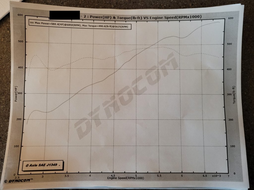

    My baseline was 325WHP jumped up to 520WHP on the "Stage 1" sitting at ~530WHP with smaller pulley and other mods.
    Dunno
    No regrets but it isn't a fire and forget process. More mods adds complexity to troubleshooting and it is likely some issues will creep up over time.
    I'm with @Silver17 though. Get an out of the box prebuilt truck boosted from the factory if you want the fastest truck available unless you enjoy tinkering or want longer term reliability. Even with a Tundra you are sacrificing reliability if you go with an aftermarket boost solution.
    On Gen 2.5 the stock engine is probably capped at ~550WHP before visiting grenade town even though some have visited grenade town at lower numbers. Stock transmission can probably hold ~750WHP with a VB kit based on one of the trucks was regularly drag raced on a strip.

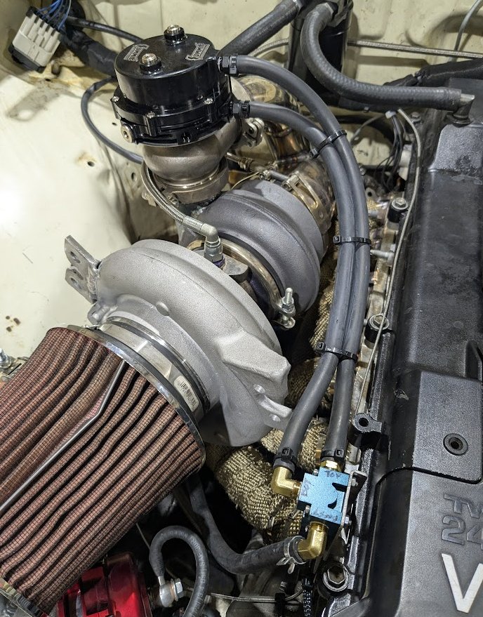

    The $100 ebay turbo on my 3.0L makes as much power as my Tundra, probably the same shit Temu has :D
