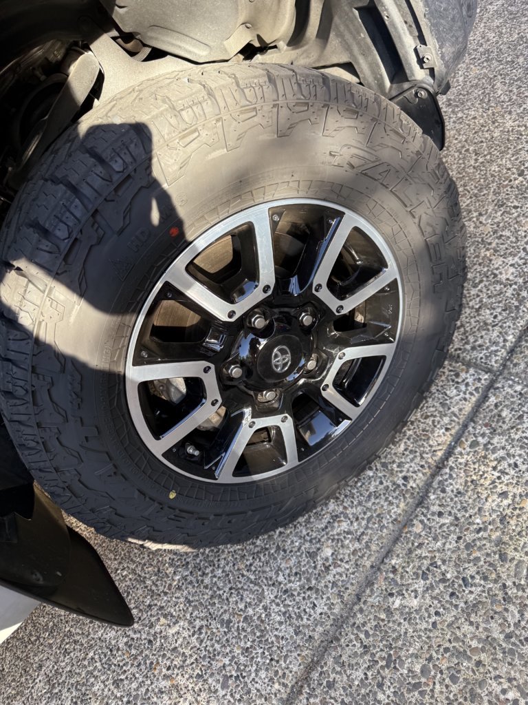

    Hello all!
    Is this a tire mark on OEM wheels to help mount the red dot or “high point” on the tire?
    Thank you much, dealing with a vibration issue.

    The yellow dots identify where a tire weighs the least — the lightest point on a tire. The yellow dot should be lined up and directly next to the valve stem, which is the wheel’s heaviest point.
    The red dots identify where the tire is flattest — the lowest point on a tire. The red dot should be directly across from the highest point of the wheel, which is usually indicated by a colored dot or a notch on the wheel.
    I've seen techs actually line up the yellow dot, but most folks have no idea what the red dot means :notsure:

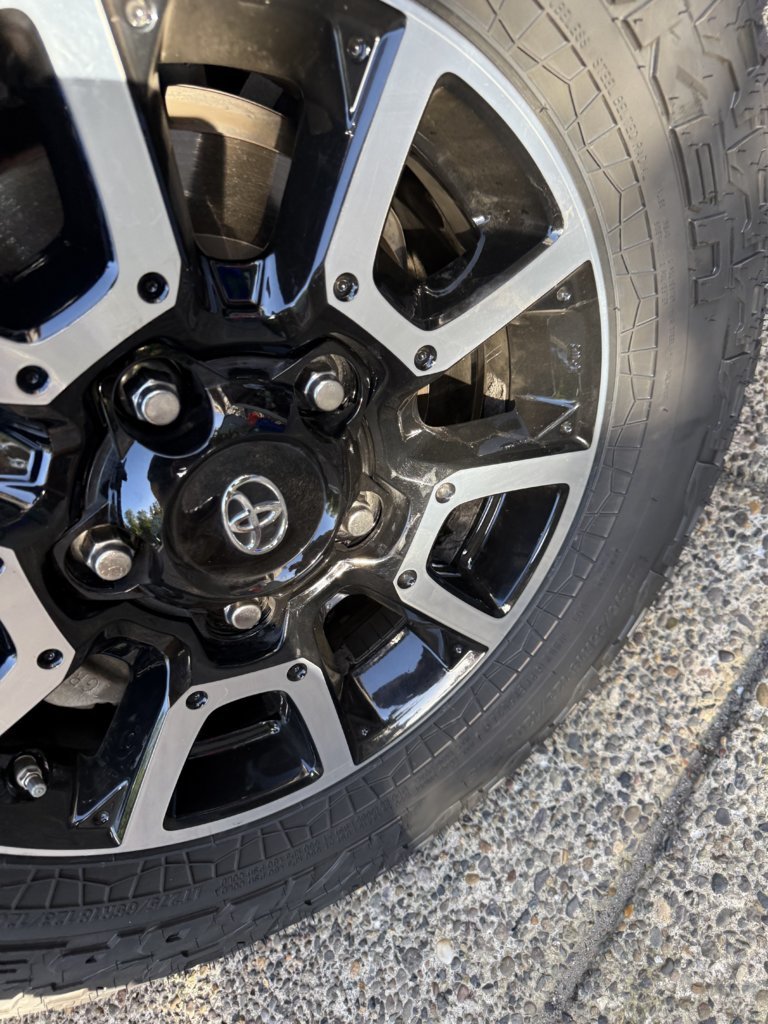

    All my yellow dots are lined up with valve stem, vibration felt in steering wheel at 60-65mph.
    Was thinking of having them road force tested.

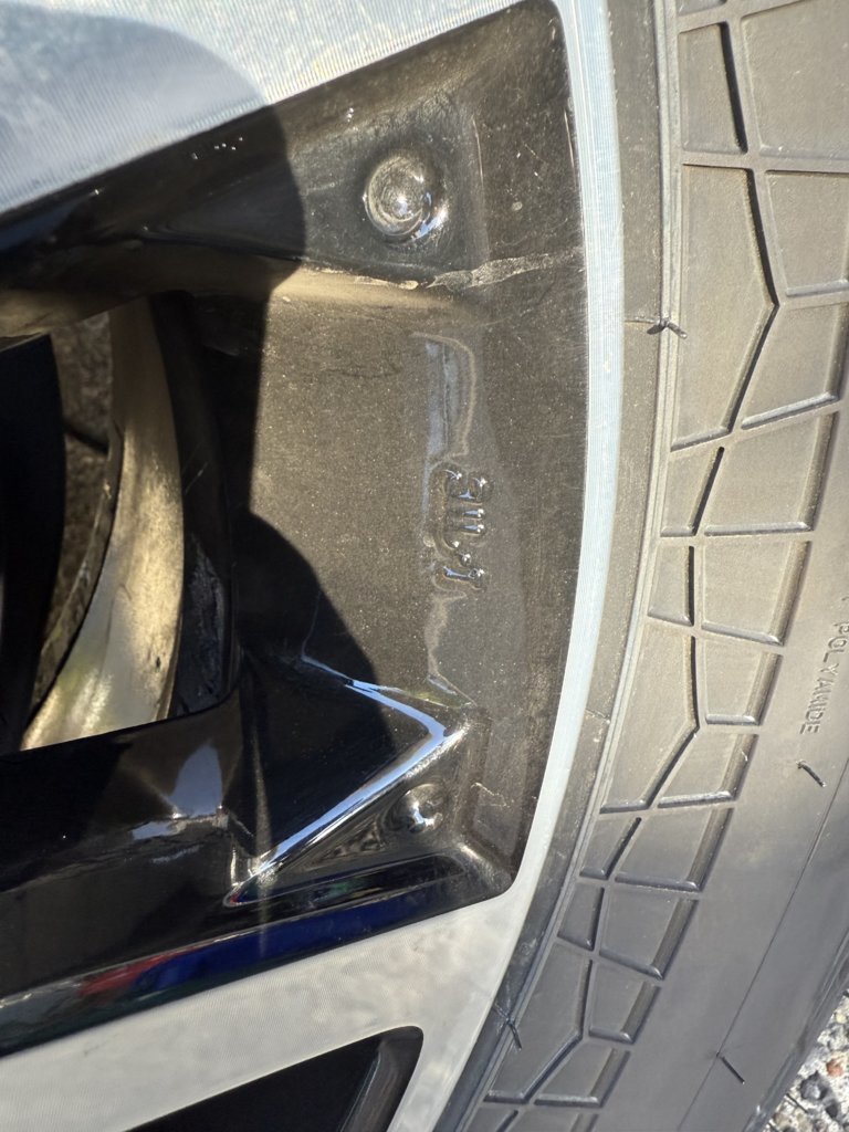

    Do you see a notch in my OEM wheel to match the red dot with?

    Most OE Toyota wheels are marked with a white dot in lieu of a notch... So, yes you'd like up the white dot on the wheel to the red dot on the tire, which takes priority over the yellow dot being lined up w/the valve stem.
    If the tires are new, I'd take them back to the shop where you purchased and make them fix it by re-balance, spinning the tires, or ultimately replacing the culprit if one tire in particular is the source. This happens sometimes, and I wouldn't want to fight balancing issues over the life of the tire.
    I've got the same style of wheel on my '08 that were take offs from a '21 OR, so I'll look later and verify they are using white dot on them...
    Also, just know that sometimes the wheels are not marked from the manufacturer.

    I checked no dots on the outside of my wheels... maybe they are marked on the inside :notsure:

    Would 1 wheel lock per tire cause a balance issue?

    No - those are big wheels and big tires. Wheel lock not going to cause an issue.

    Ok cool, I work in a bad area of town unfortunately so I didn’t want to remove if not needed.
    I did weigh them against the stock OEM lugs and weigh about .25 oz more than stock lugs.

    One more question, can left over wheel weight adhesive cause a imbalance?

    No - you have a big mass of tire and wheel spinning. Balance can be affected more by weight that is closer to the perimiter than the hub. The lug lock you talked about is near the hub so won't do much plus it weighs about the same as a regular lug nut. The adhesive hardly weighs anything although it is closer to the perimeter - won't materially affect the balance. You had talked also about cleaning the tires. Mud could affect the balance as it is on the perimeter but there would need to be a fair amount.
