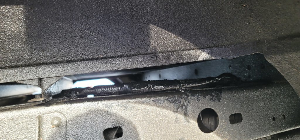

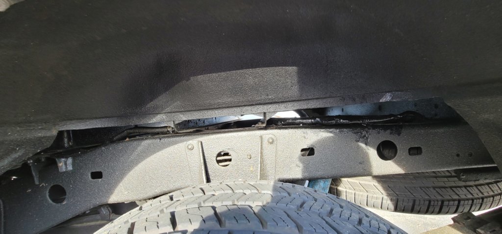

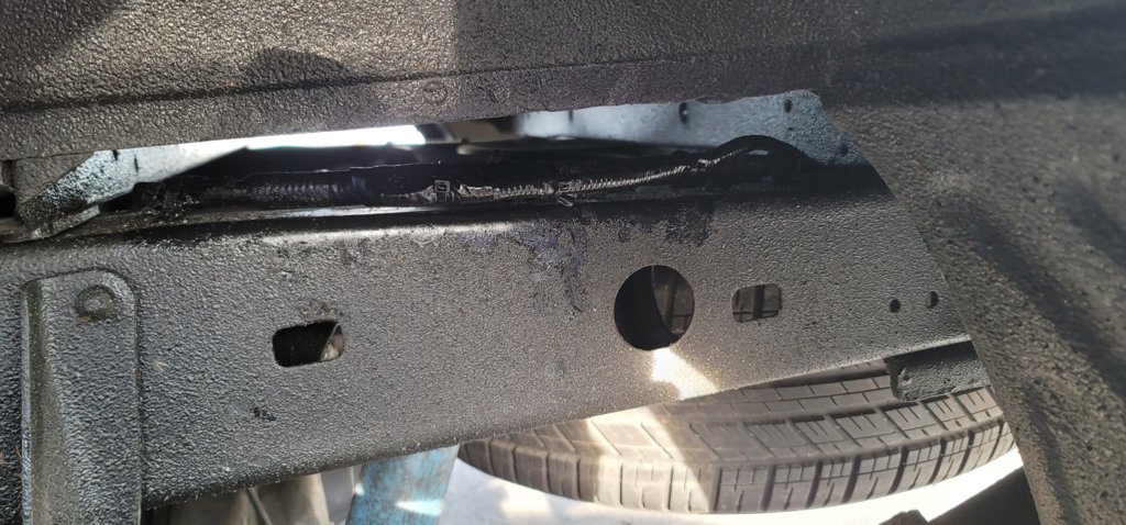

    Uh... I don't seem to have one of those... ?

    Early models did not come standard with any kind of trailer harness setup. Adding a converter was required. Even my 2000 Limited with all the options (laughable) did not come with a hitch or harness. I added both, used the Curt box similar to yours but circa 2006. There’s a series of connectors under the bed back there that send the signals out to the tail lamps. Run those wires and make sure there’s nothing unhooked or corroded or broken

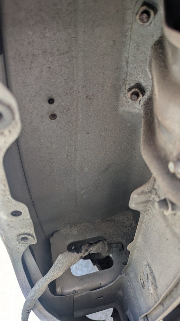

    OK I think I found at least some more info... the folks at etrailer say that this center connection/black wire on the truck's connection should be 12v constant, but I'm getting nothing. Anyone have a wiring diagram that shows where that wire is coming from?

    That is the T 9 Trailer Converter connector. The black wire should indeed have 12vdc. That black wire goes up to the engine bay to a 1 pin Option Connector O 3 which is beside the battery. The Curt harness has a inline fuse that was tied to positive of battery. That conductor plugs into the O 3 Option Connector. Check that fuse and/or O 3 connector.
    If that fuse is good, connection to batt is tight and Curt connector plugged into O 3 good, the next place it could be missing is the I 4 connector at the drivers kick panel. Panel by parking brake.
