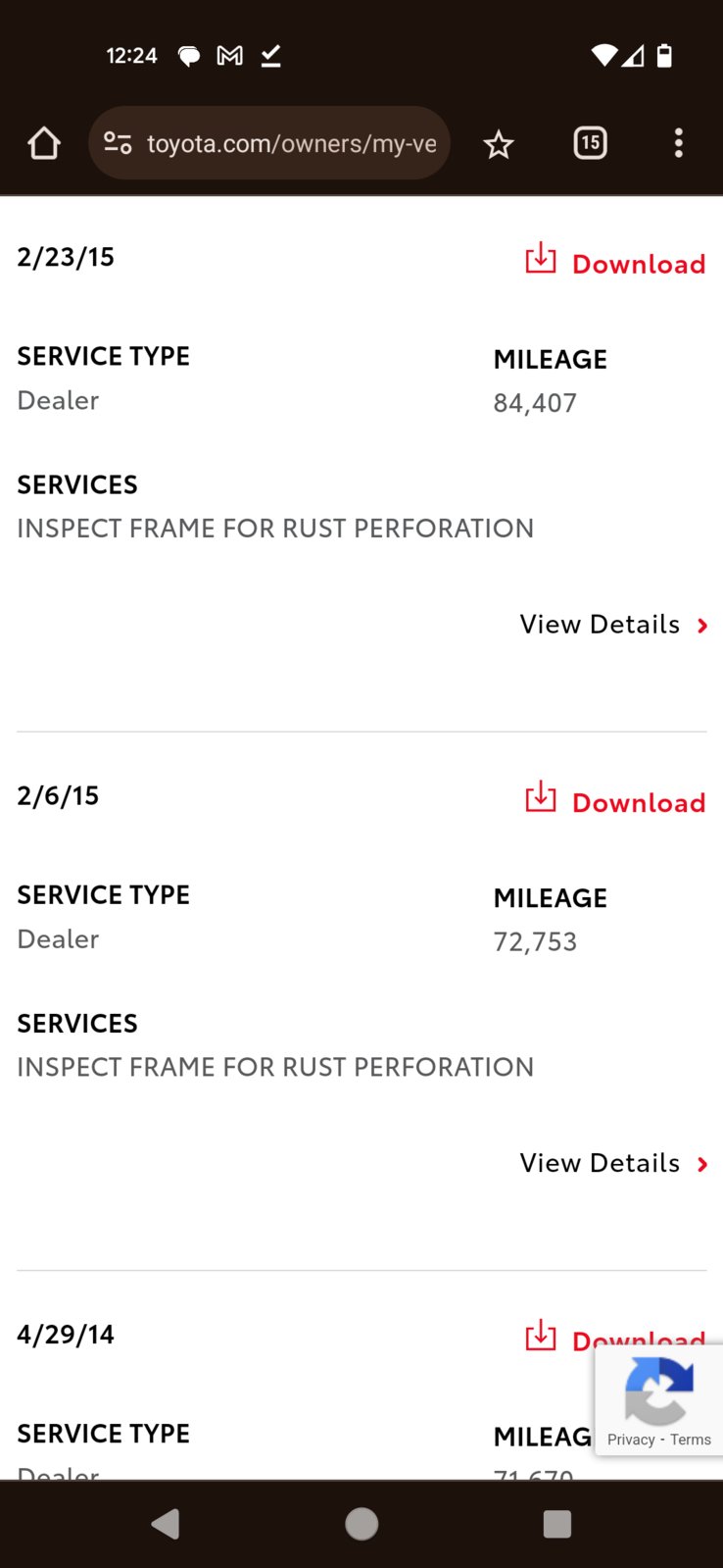

    I created an account on Toyota.com/owners and looked up the service record. It just shows "rust inspection" nothing specifically about doing any treatments or repairs already to it. I dunno if that helps me or not but I read if they already did something they treat that as a completing the recall..

    Sounds like your truck may qualify for a new frame to me. Although, you should check the “details” to make sure.

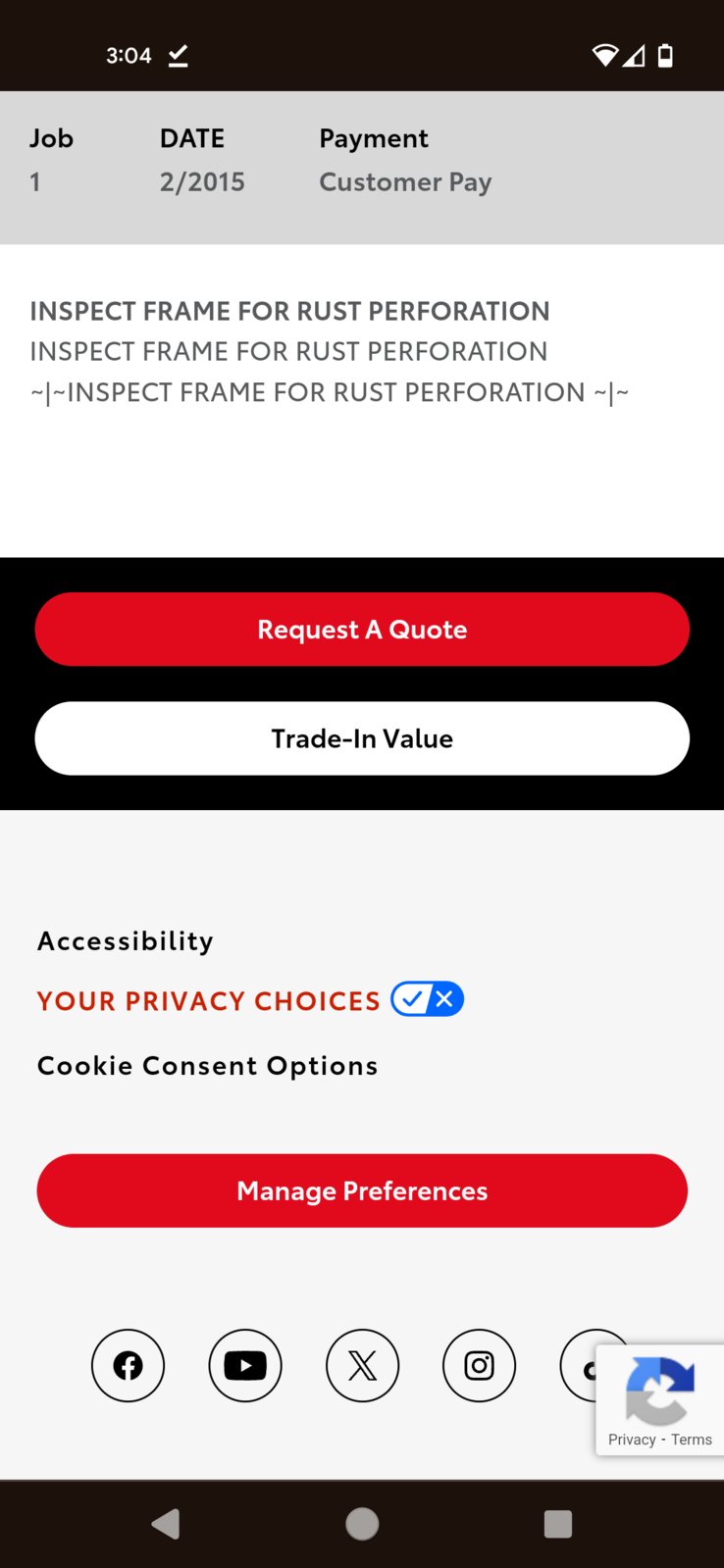

    Thanks Jack,
    Under details both just say "inspect frame" under details. Nothing about any service done.

    Well, they definitely had it inspected. Whether or not it qualified and/or they chose to receive the spray is the killer. But whoever owned the truck in 2015 knows the answer to that.
