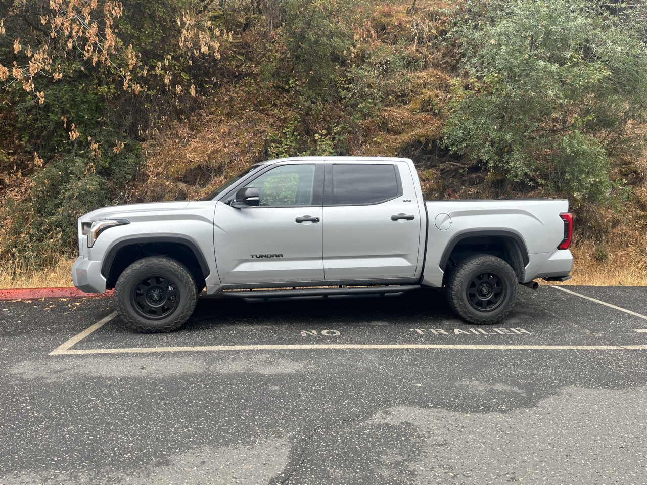

    I put the 1.75" RC kit in and the first pic shows the truck very level. The second pic shows the drop with the 4,200 lbs trailer.
    I have added a 1" spacer kit in the rear since these pics to help the rear come up a bit so it can be closer to level with the trailer on.
    The ride up front didn't change but when I put the rear spacers in, the rear softened up quite a bit. It is almost like the rear shocks are too long and lifting them up gets them moving but I could be wrong.

    Appreciate the response. Sounds like the kit worked as planned; your truck looks great! The levelled stance with the long bed looks solid. My trailer weighs 4500 dry, so this is a great frame of reference. This is definitely motivation.
