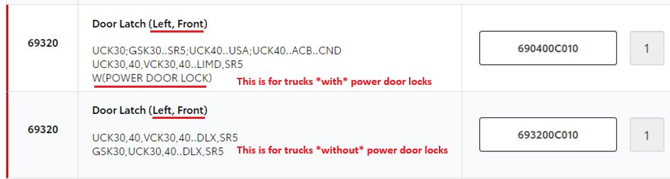

    Anyway, here's the Toyota exploded for your door parts: https://parts.toyota.com/a/Toyota_2...1696/FRONT-DOOR-LOCK--HANDLE/841420-6753.html
    Clearly there is only one part number for your door on each side, one for power locks and one for non- power locks (see descrption for left/driver side here, bottom p/n is for your base-level truck) and it doesn't match what's on eBay:
    693200c010 is the part number you want. https://parts.toyota.com/p/Toyota_2...or-Latch-Left--Front/63491390/693200C010.html

    And here is why it's different - As you see here, the part number you provided from fleaBay is for Double Cab trucks and Sequoias, which share a lot of the same parts with each other, they're the same vehicle with a bed. Access Cab and Regular cab share parts with each other too, but not a lot translates between Seq/DC and the AC/RC. As @Mr.bee already indicated... (And this may answer your question @Mr.bee)

    Thank you @shifty` ! Called the dealer to confirm fitment and ordered the latch at a 30% discount. You are a lifesaver

    @shifty` Yes it was a perfect fit. Definitely going to use the online Toyota parts service for all future purchases.

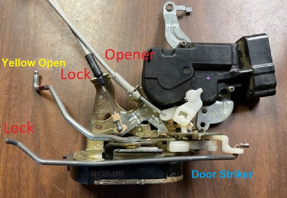

    Looks like RC has with power and without on D side but passenger side only has one part number? I guess (after watching the video) that you have to transfer your electronics over as indicated, hence only one part number needed/available. Which makes me wonder if you can maybe use the non-power part for the D side but I'm guessing maybe the mechanicals are different.
