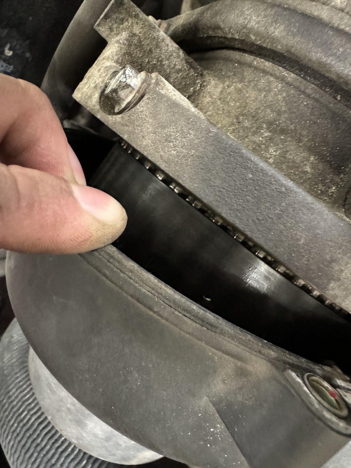

    Wanted to know your opinions on the condition on this timing belt. Am I in the unsafe to drive category? I am unsure as to when it was done last (which makes me want to have I done) Carfax says last was 30k miles and I am at 160k which is like 30k+ over.

    It looks pretty crunchy to me. When was the last one done? My vote is as soon as possible.

    I concur, definitely cracks there. I wouldn't really be driving on that much.

    I can infer that a visual inspection is not adequate, because my buells belt, that is exposed to uv regualrly was in better shape than some pics of toyota broken belts, when it broke. When it does break, throw it in neutal instead of hammering on the gas. You'll probably feel it.

    Peace of mind is worth it. My 40k-mile belt looked brand new at 23 years old when I changed it.

    I’m planning on having it done asap and will avoid driving on it until then. I’m not sure when it was last done.

    30,000 miles over should of been all you needed to know.
    Change it.
