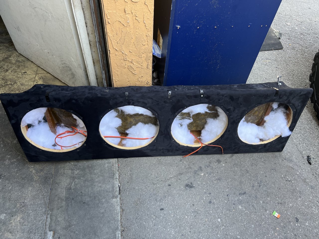

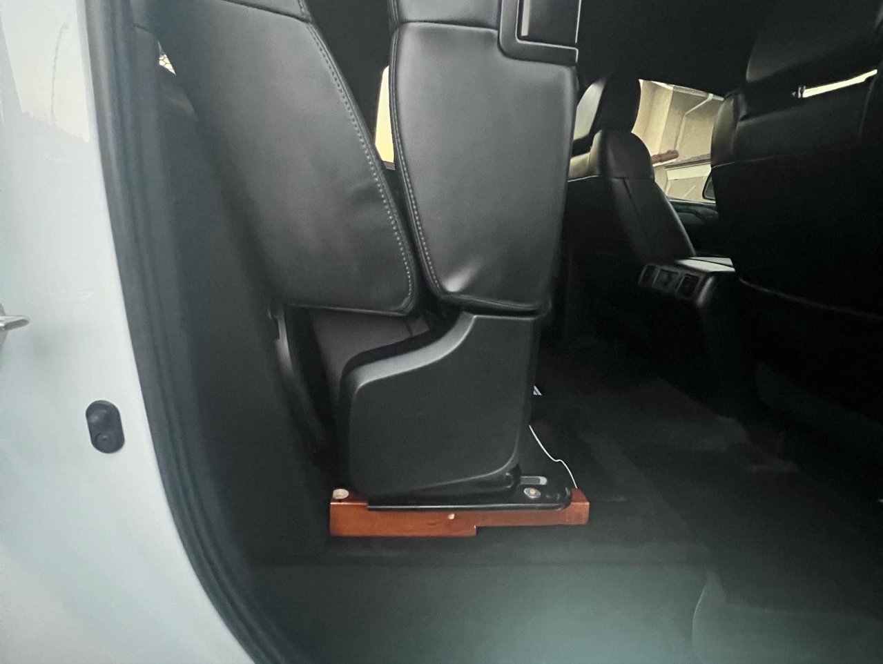

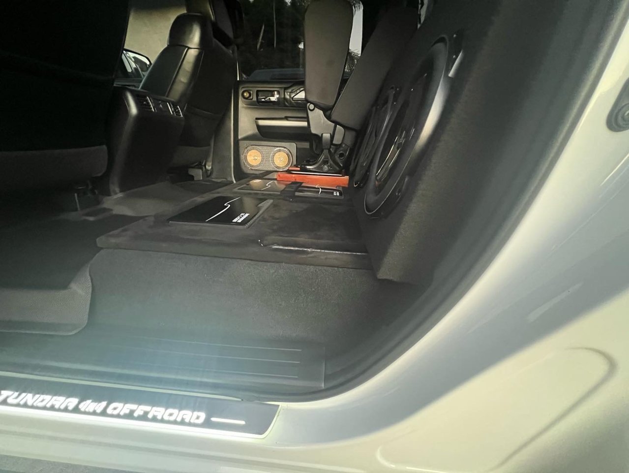

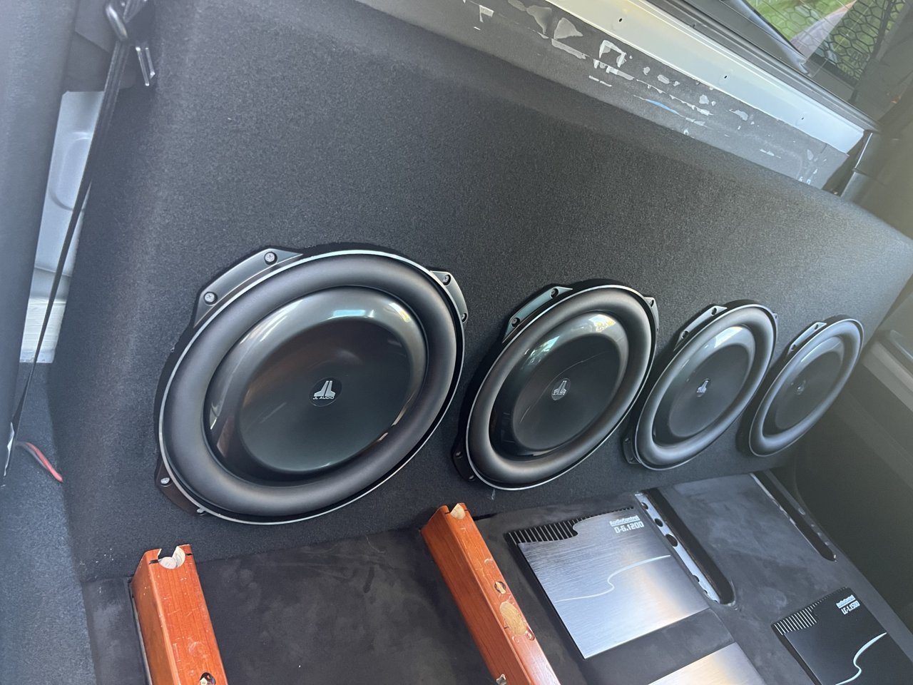

    Its a bit of an ambitious built, Im not sure how many folks are willing to drop that much $$$$$ on a hi-fi audio system for their tundra but doing so, the sound clarity is just amazing. The subwoofer box was redone 3x. The fiberglass looks good but the sound delivery was not there. So I went with a 1” thick mdf fully sealed and lots of brace and 2 separate enclosure. The subwoofer are paired off to 1 amp each running at 2 ohm along with all my components running at 2 ohm full active no crossover. The DSP on the audiocontrol are amazing. The full system hits a full spectrum of 20hz to 22khz.
    Here’s the specifications:
    1 set of Focal 3 way K2 Elite
    3 set of Focal 2 way power series
    2 Audiocontrol D6.1200
    2 Audiocontrol 1500.1
    2 Northstar X2 AGM BATTERY
    4 JL Audio 13Tw5 V2 4ohm
    Alpine Headunit ILX-f309
    Starhead liner
    Sound deadening full interior cab head to footwell 572F74DC-3E4F-4A31-9E0F-05107F749BD1.jpg 572F74DC-3E4F-4A31-9E0F-05107F749BD1.jpg A6A8E4DB-C5FE-410C-82F9-CF5E7122A2B9.jpg5AABF4AB-7D7D-493D-A8DC-C9AFF98A97FC.jpg0D8602A6-BFD2-4955-982D-6B699F1C4C99.jpg1CE23DE1-9682-47CF-A54E-2CDD48C17C41.jpg09C6CECF-71CC-400F-8613-D8C859453055.jpgBE02427D-A222-4372-B53B-213723BF8590.jpg
