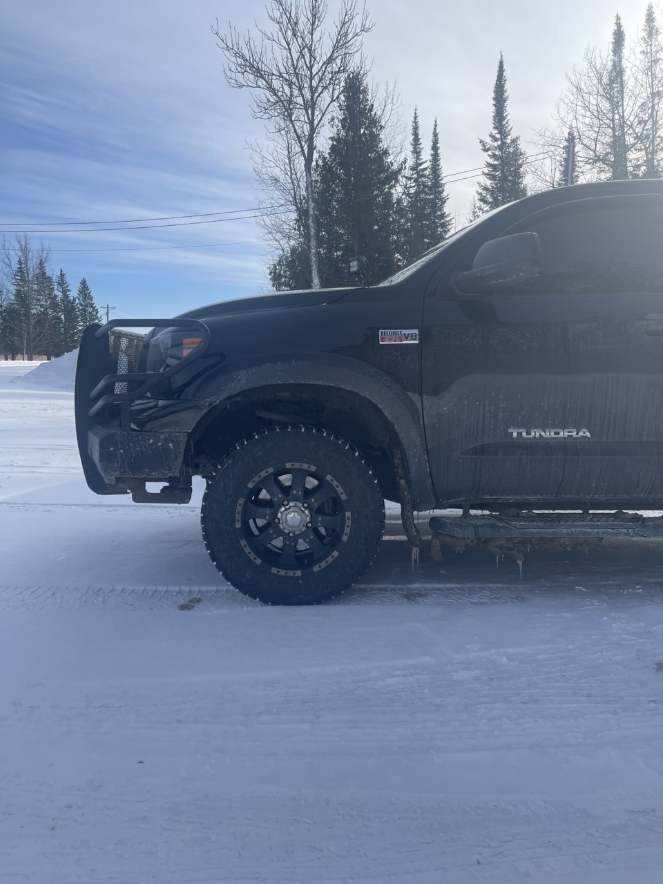

    Hello, I am going to be putting a RC 6 in lift on my 08 tundra. I have a ranch hand front bumper. I am thinking on running 37s but I don’t really want to trim… if I did have to trim where do you think I’ll have to or not or should I just play it safe with 35s? I don’t know offset with my rims but I took a picture of them so you may have an idea but not very aggressive. Thank you and here are some pictures I took.

    I don't have first hand experience with your setup but I would imagine you might be able to fit those without bmc since you have a high clearance bumper. You can probably caster your way to fit.

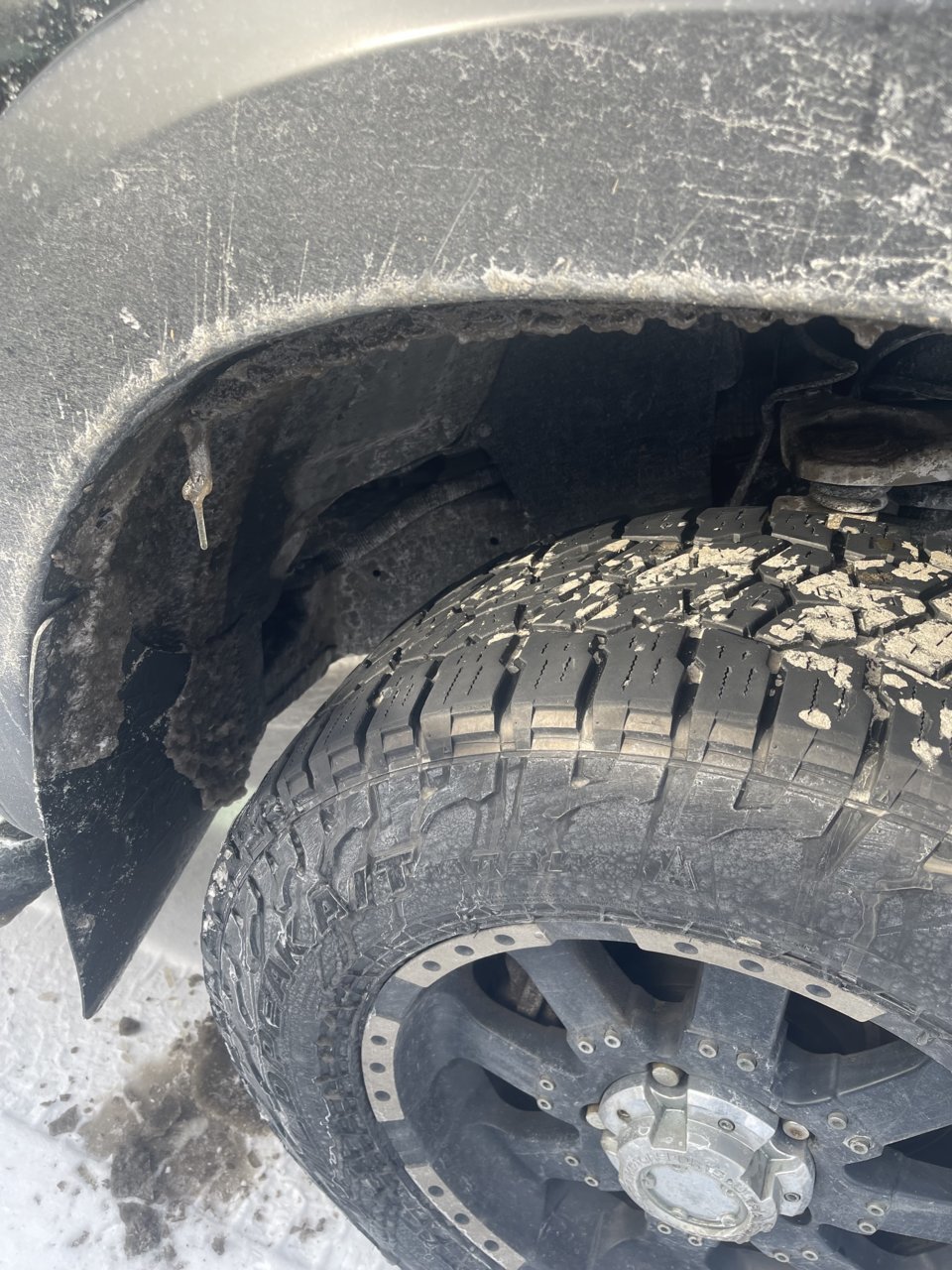

    Alright thank you. I just didn’t want to end up ordering 37s and end up slicing them up on my bumper but in the back frame area there on the second picture is where you are talking it may rub?

    Have someone stand outside your truck (driver's side front wheel), start turning your wheel to the left, have them tell you when the outside lip of that tire is closest to the inside of your fender well (closest to the driver). Take a pic and post it up.
    Also, look at both tires and how close are at full lock to the the skid plate on BOTH sides

    You will need to trim at least the cab mount even with the 6" lift. Trimming the body and fenders depends on tire width and wheel offset.
    I have 37x13.5 on a +28 offset and 6" lift. It doesnt rub the fenders, but i did cut the body mounts. I have a different bumper. If it does rub the bumper it would just need a small cut off the corners. 35s will clear much easier.

    Yes the body mount chop is needed to fit 37s
