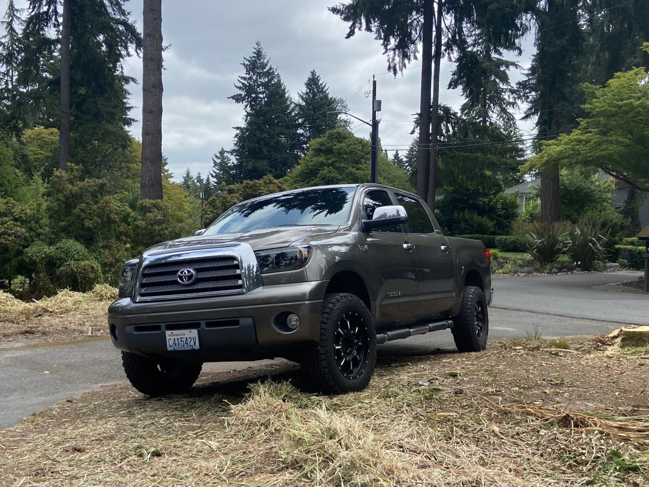

    Hi thanks for the reply I don’t do much of nothing with it just haul small stuff and it’s more of a family truck per say

    Thank you for sharing that my truck is 4wd and it currently has I believe a 2or 2.5 lift
    It came like that when I bought it.

    basically the design of our suspension has a reasonable range in which you can add height before you start having issues with wear components(cv boots, ball joints, even alignment). 2.5 is that sweet spot imo. Going over that you are really pushing the margins of our suspension design imo. There are a few products out there offering 4 inches of lift for the tundra without being a full lift kit, but they will cause issues, and ride like total crap
    To go higher, the 6 inch lifts come into play, which reset all that suspension geometry just relocated lower, thus raising the truck up.

    Truly appreciate all the great info and sharing your knowledge I honestly have been having issues with tire rubbing ever since I ditched the stock 20’s and replaced them with Fuel wheels. that’s kinda why I’ve been considering lifting higher.

    Search BMC on the forums. The wider set wheels cause the tire to hit the body mount. You can trim/plate that mount and then you will fit your current tires perfect. I did mine when i had that same issue.
