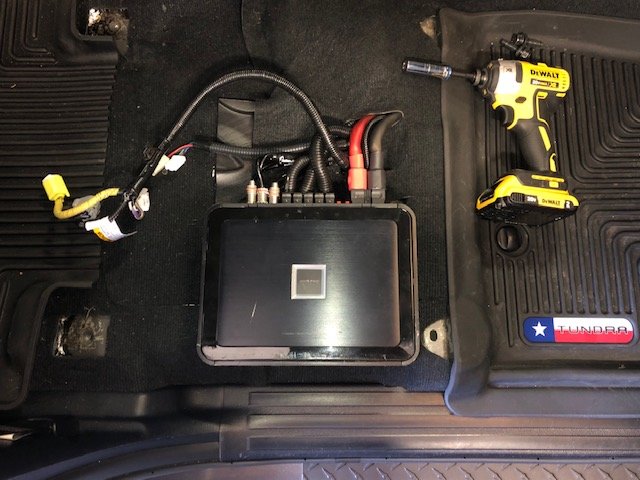

    I'm running a 5-channel Alpine PDX V9 with Focal components in the front doors, Focal coaxials in the rear door, and a JL Audio Stealthbox SB-T-TUNDB3 with 2 10TW3-D8 Subwoofers.
    Using a Kenwood Excelon DMX906S HU.
    Once I got it dialed in, and the subs wired correctly, it sounds great..
    500 RMS watts is plenty for these subs.
    If you're only going to run one sub, there is no reason to run separate amps.

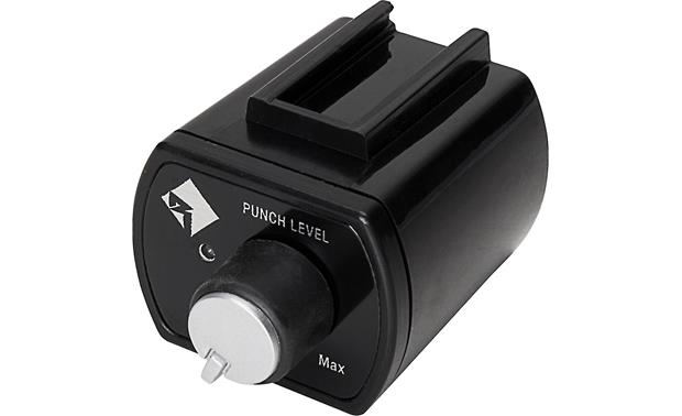

    If you do use that amp, I'd suggest the Rockford Fosgate PLC2 remote control to control your sub levels..
    I adjust my subs levels on almost every song or genre..
    Rockford Fosgate PLC2 Remote control for 2013-up Punch and Power Series amplifiers with C.L.E.A.N. setup system at Crutchfield

    My 5 channel Alpine, with 0 ga power feed, in case I ever change my mind...:D
    r7df2zr7_zpscoegh5fw_e14e4e071c704d230b554daebfcc38c675bc6089.jpg gvap7jp5_zps2iu2ff0k_d96cfe3ea84a9c27a2f9bef8710842f8f3a4af4f.jpg
    And don't forget the 0 ga battery to chassis ground run..
    TRDFerguson[OP] and 619Tundra like this.

    FOCALS are the brand im going with too ! Do you have a pic of your sub installed that you could post ?
    Thanks

    Do you have any pics of your amp and subs. Thanks.

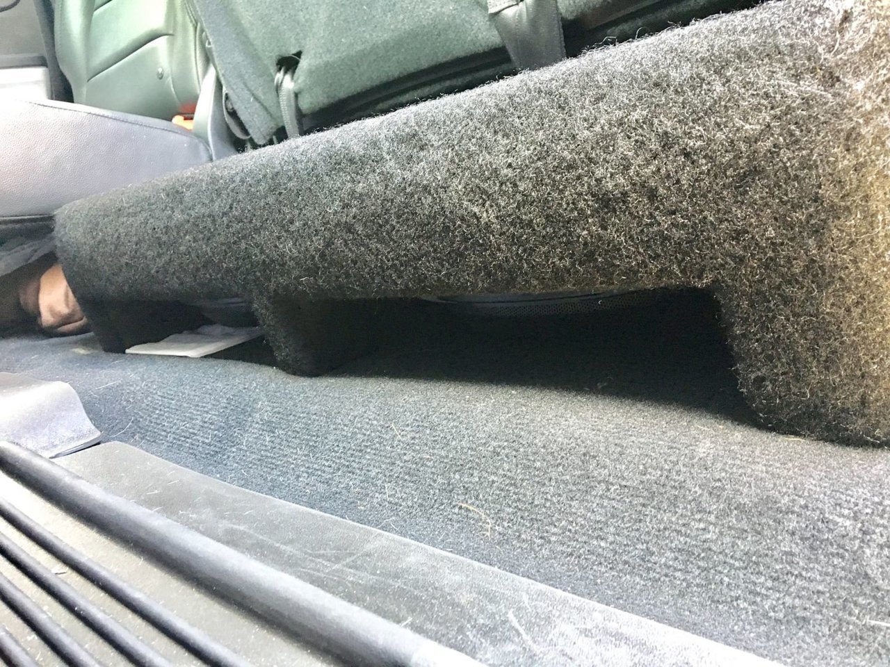

    I have a double cab, the SB-T-TUNDB3 Stealthbox was made to fit under the rear seat..
    IMG_1618_zps2oofmjfl_253e6e7bca4d698f2afd3d87597eef9a654ead0d.jpg IMG_1616_zpsskszdojb_b0f02fc5fe4699deadab8e9489baf631ad5103ea.jpg 82DE4E42-F7E5-49A3-B972-55194F2F7411_zps_1c155c43755c48f928aa31d91d5a106d15350c8e.jpg
