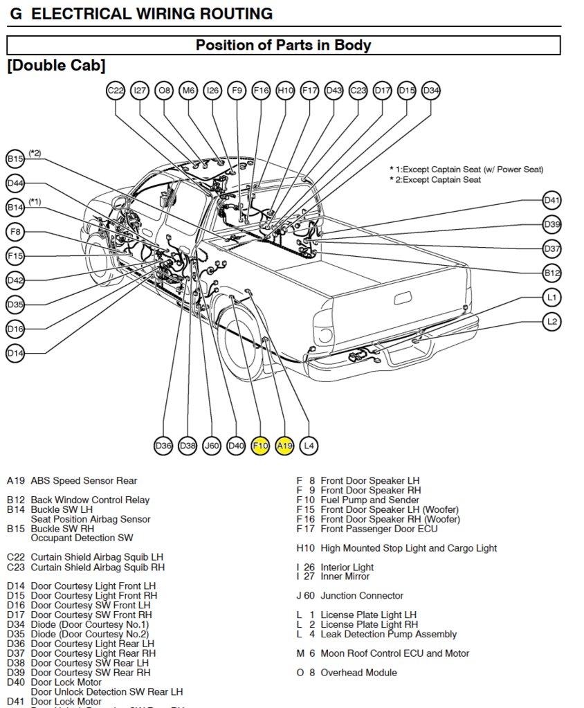

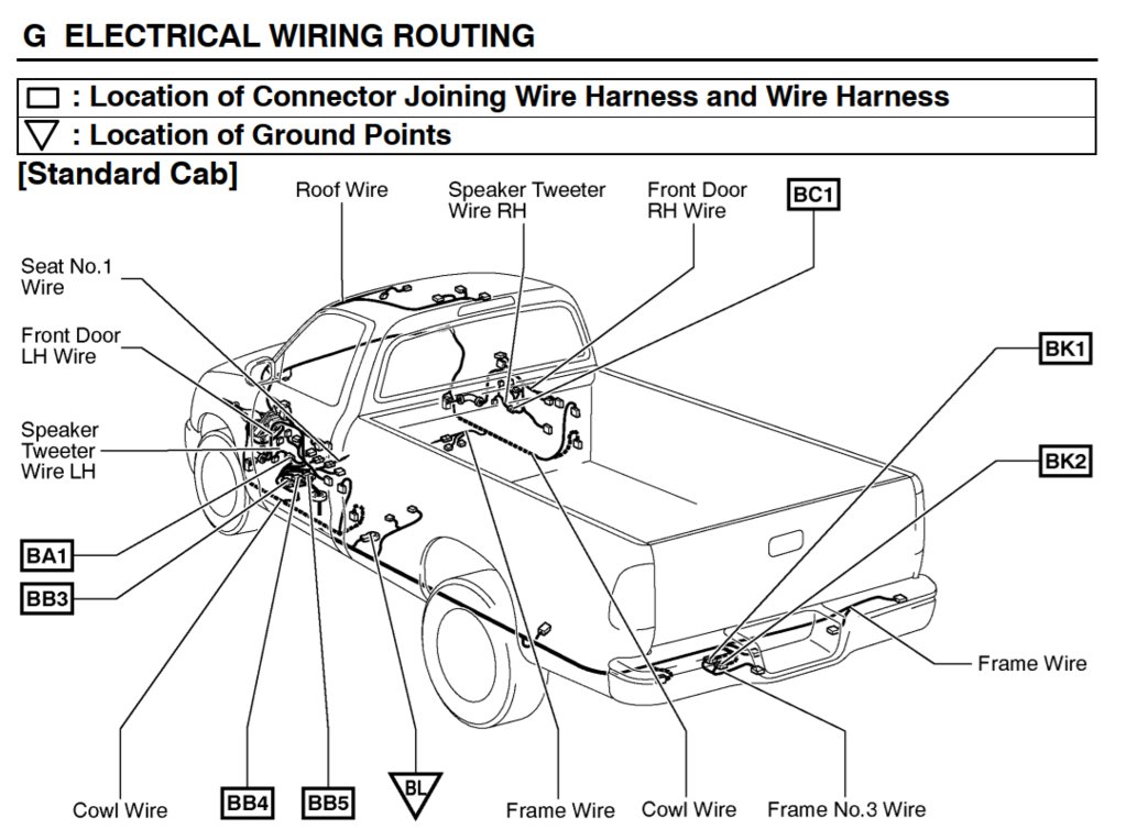

    I have a 2005 Toyota Tundra with almost 275k miles on it. About a week ago my ABS light came on, then yesterday my speedometer, odometer and cruise control stopped working. Could it be the ABS sensor or Speed control sensor? are they one and the same? If this is the problem, where specifically are they located?

    I’m pretty sure you’re not right on this. I swear things changed in ‘05-06 and part of the changes are why you can’t easily Yellowbox the VVTi trucks. Has nothing to do with VVTi, only using that reference to pinpoint years. But totally possible I’m remembering wrong. Would t be the first time. I just have it set in my head the latter years used ABS/WS sensor input to gauge speed. It may only be rear sensors. Or front sensors. My memory is limited.

    It didn't effect Johns odometer when I broke his sensor nor did it impact it when we unplugged it.

    No that's not what I was saying. There is still a wheel speed sensor in the knuckle just like my truck. Empty is saying that the speed signal is generated at the ABS pump. I think people sometimes interchange the name wheel speed sensor and ABS sensor. I don't think either one is actually controlling the speedometer on the 05-06's. If it was John would be fucked.
    If you read through that thread, they talk about the ABS computer being responsible for speedometer output.
    Nothing. We disconnected the sensor along the frame rail and now he lives with the ABS light like me.
