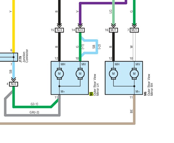

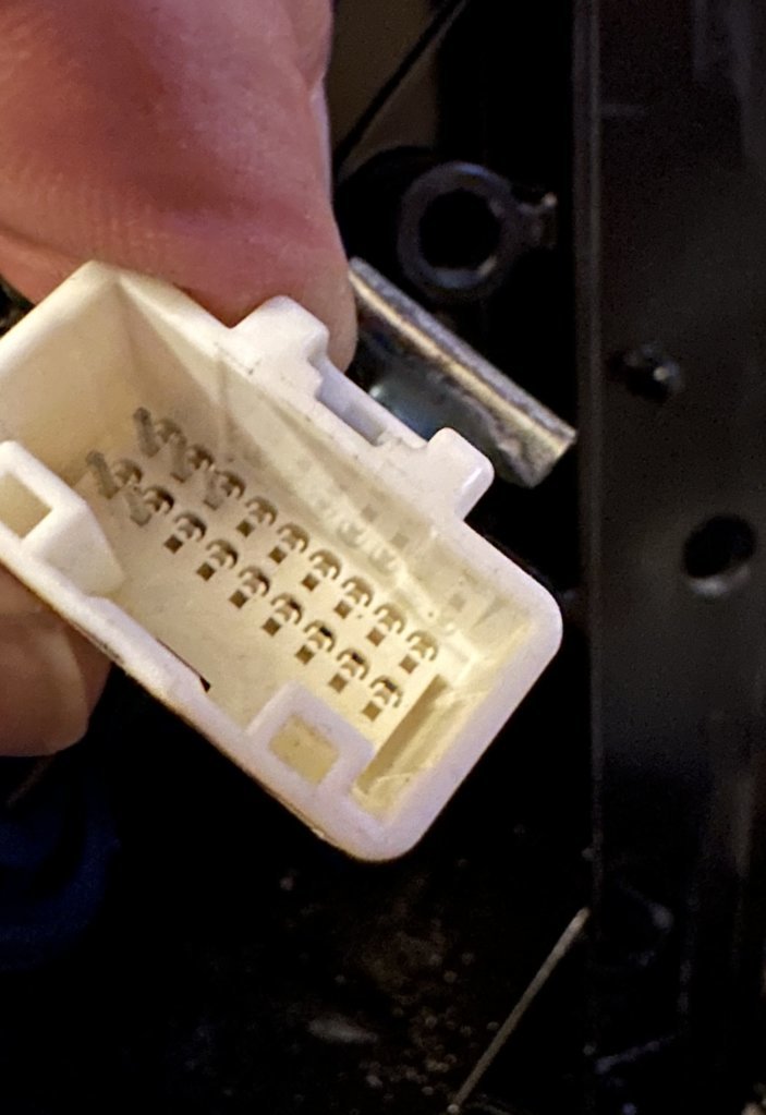

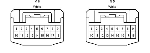

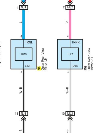

    You need to test these pins/wire with a DMM to see if your mirror plugs are getting a signal feed.
    Going to be N5 and M6 are your mirror plugs.
    Pin 4 will be hot on/off for the signal, red on the left and pink on the right.
    Pin 3 the ground.
    Turn on your 4 ways and give it a shot..
    On my 2014 they were not hot and I had to run my own wiring from the kickplate for my Muth mirrors.
    If they aren't hot, you can look on Muth's install diagram.
    21000300RevE3 (muthco.com)
