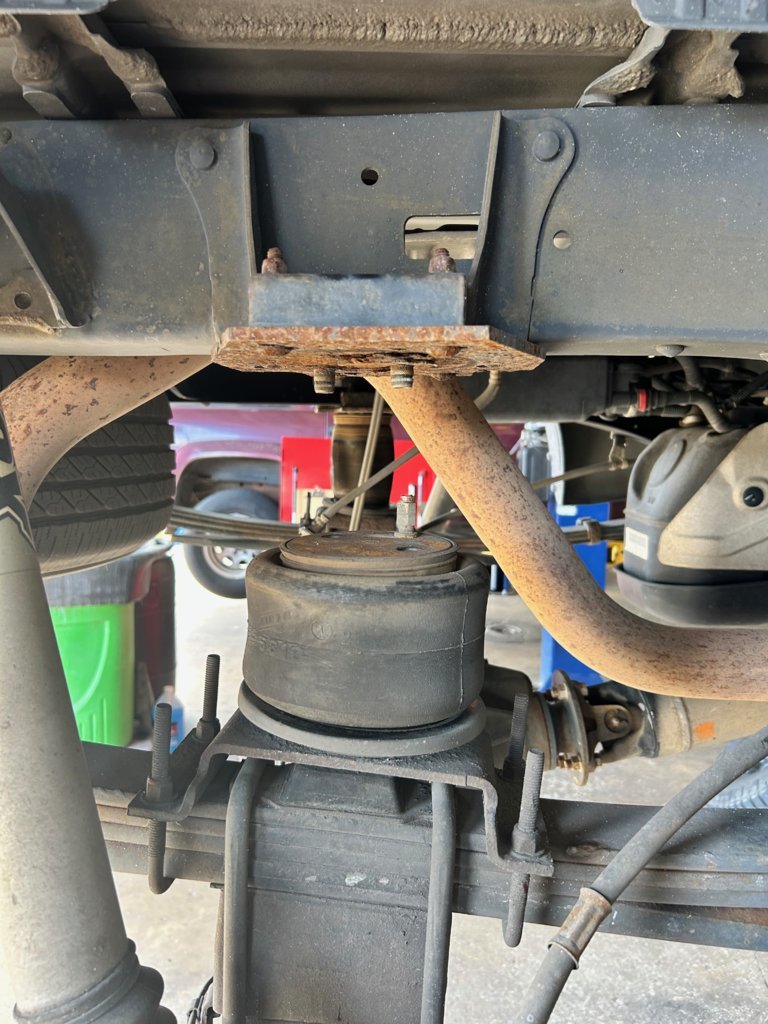

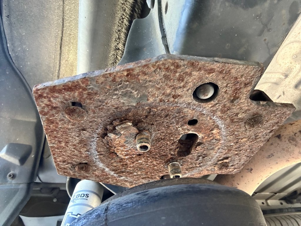

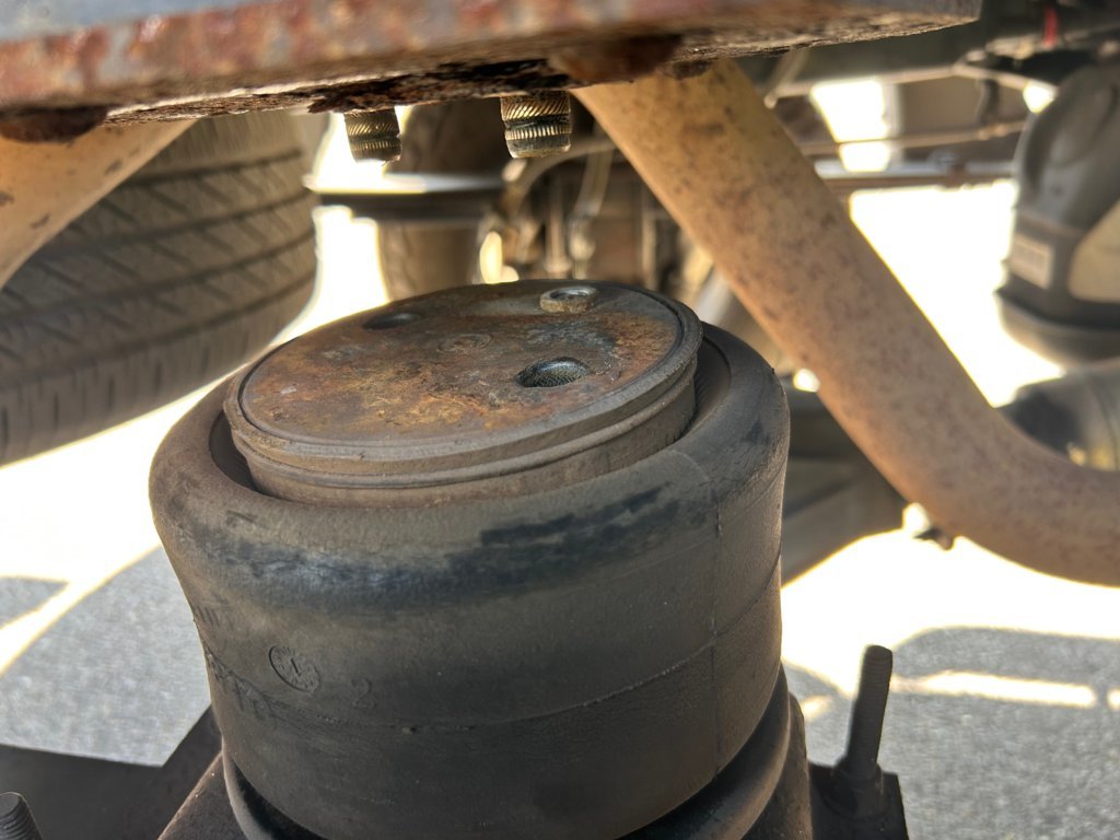

    I got my tires rotated yesterday and the tech noticed my passenger airbag has separated from the bracket... I hardly use the bags as the previous owner installed but I do want to get this fixed. The bolts that attach to the bag look like they have broke. Is this something that is fixable by someone that knows what they are doing or is a whole new kit needed? The other bag is fine and still works. Thanks!

    I believe that is a PacBrake kit. Perhaps you can reach out to them and see what they have too say. It appears to me that the top plate inserts have failed and pulled out of the bag - I'm guessing due to axle droop. Note the distance between the top plate of the air bag and bracket on the frame; I'm not sure the airbag has that much extension built in to it.

    It is a Airlift 5810. Yeah they lifted the truck from the frame which drops the axel but I think it had separated before then.

    Ah, I forget Airlift also did a single bellows bags. Most airbags have a lifetime warranty; that failure is non-repairable IMO. You can glue the fittings back in to the top plate but since they are a pressed in fit, that will mostly just keep the bolts located for while but they will pop out again once you droop the axle. Contact airlift and see if it is a warrantable item. Last year, I had a Firestone bag start to fail. I contacted firestone and politely asked if I could purchase a new bag from them and for advice to keep them from failing. They asked for some pictures of the failure and then sent me a new one free of charge, not hassle.

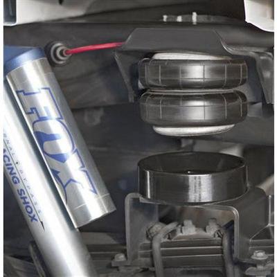

    I would also invest in daystar cradles. This will never be an issue again.

    What are the benefit of these cradles? What do they actually do?

    They allow the axle to droop without pulling down on the airbag (the most probable reason for why your airbag failed).

    No prob. I’ve used a set of Daystar cradles since I installed my airbags 6 or 7 years ago. They are great and function as advertised.
