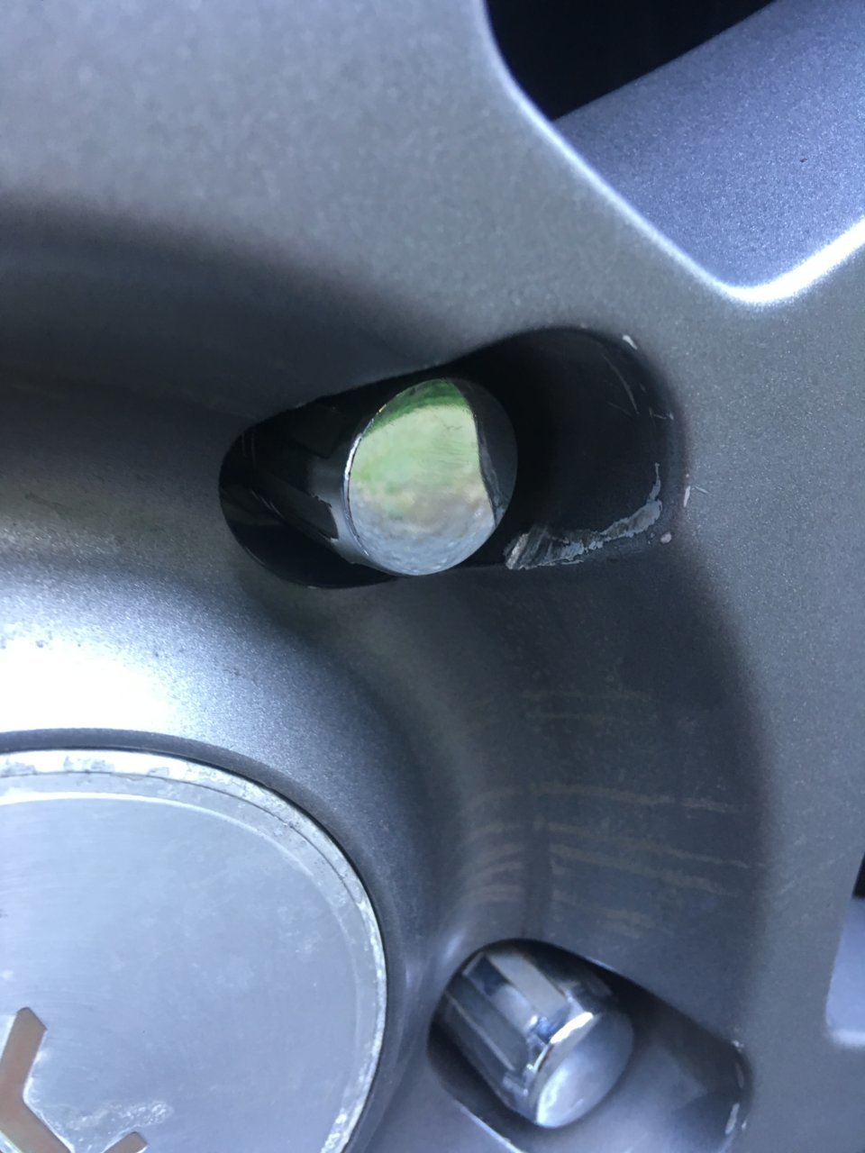

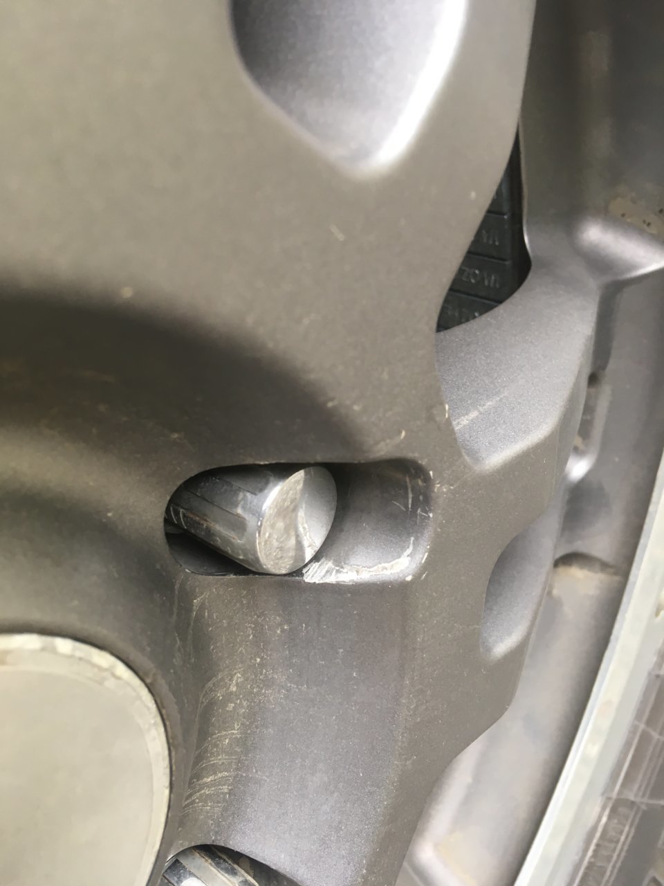

    Took my 2016 into Discount tire to get the routine rotation and balance (every 5k) not only did they scratch and take metal off my wheels, which were like new. Now my alignment is way off pulling hard right. Tire ware is not the issue. Tread is the same all around and even. Took it back and filed a complaint but they won’t help with the alignment. What would cause the alignment to change that much?? It was perfect before!!

    That’s what I’m saying, heard back from regional office, they got ahold of the shop and I called and the manager is aware of the problem. I don’t know what they did, the truck was perfect!!

    They got me new wheels, alignment seems to be good, not like it was, but better!
