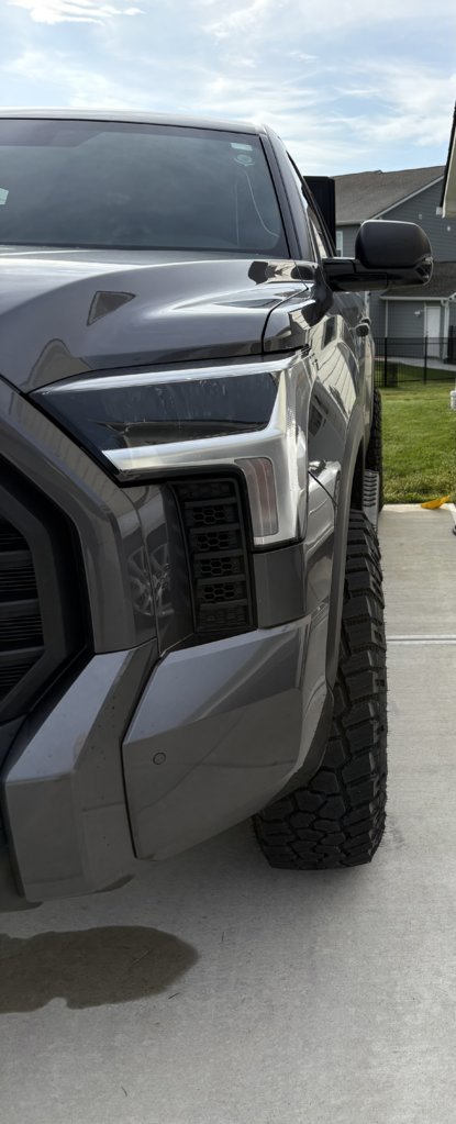

    I'll take some pics at full turn, I am close but not rubbing.

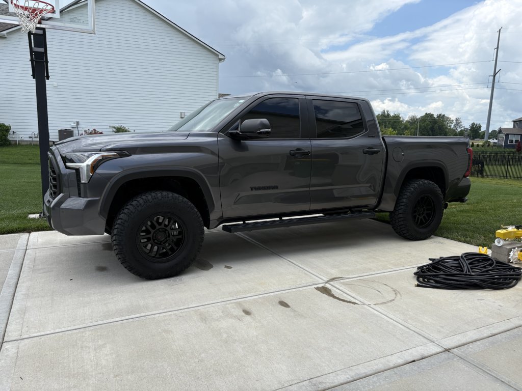

    Perfect size for maximizing sidewall and not having to chop up or otherwise modify your truck. I’m running a fully OEM setup except for the tires. All I did was remove the little flaps in front of the front wheels.

    285/75/18 Toyo OC3… MCM/ADS kit, I did the BMC more for future, no front flaps, factory front bumper. I like the pizza cutter look, no rubs. Great tire size!(came from 295’s)
