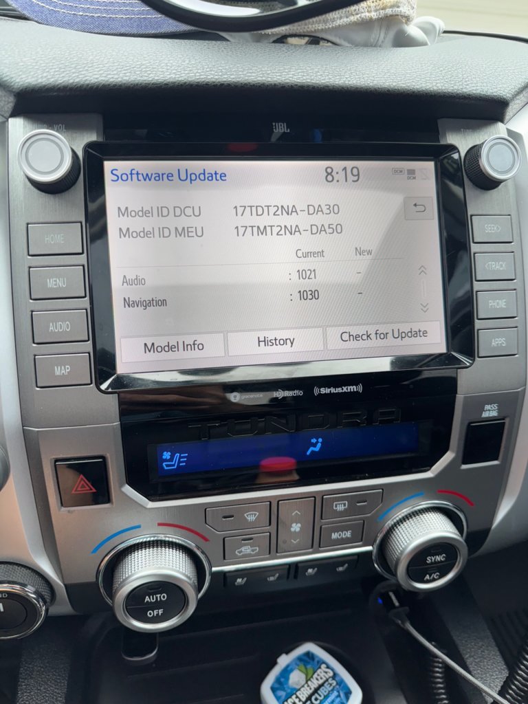

    Hey y'all, want to thank everyone here and on the other threads for posting. It sure does help when we share.
    About 6-9 months ago my CarPlay started acting weird during calls. Everything else working fine.Music, texting, Siri, all good. But calls were choppy, slow, screen would stall and freeze. I ordered a replacement OEM USB port from ToyotaPartsDeal for about $100. But before the swap, I thought about reading up. Found you all and reports of the same crappy performance.
    So, here's my experience:
    2020 Tundra SR5 CM TRD 4x4 OR + SR5 upgrade package - factory premium audio w/NAV.
    My unit pre-update specs:
    Model ID DCU 17TDT2NA-DA30 - software version: 1021
    Model ID MEU 17TMT2NA-DA50 - software version: 1006
    Tried to follow Toyota's instructions which as we all know are vague, inconsistent, and lacking detail. I first formatted a USB thumb drive on my Mac and load it up software;
    17TDT2NA-DA30_0066.kwi
    17TMT2NA-DA50_0066.kwi
    Did not work.
    Took advice from folks here and formatted my Sandisk 4GB on my PC as FAT32
    Loaded both .kwi files above unto USB thumb
    Started truck
    Went to the software update in the menu
    Plugged in the USB
    The system saw the USB and said "checking"
    Then nothing for a while
    I went back and forth through the menus, check update, etc until ...
    The bottom right button finally said "update available"
    15 minutes later, done.
    Update took about 10 min total.
    My unit post-update specs:
    Model ID DCU 17TDT2NA-DA30 - software version: 1162
    Model ID MEU 17TMT2NA-DA50 - software version: 1150
    HulkSmurf14 likes this.
