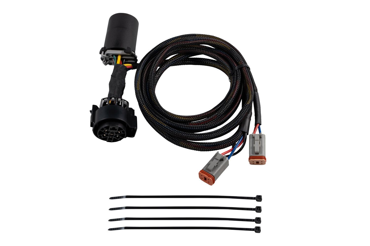

    The panel comes off and then you can determine where to place your lights, there is not a lot of depth available behind the panel, so that will dictate where the light gets placed, otherwise it is a pretty straightforward install. With the Diode Dynamics harness connected to the 7-pin trailer harness, it was just plug and play, no wiring gets cut or spliced.

    The wiring harness for the 7-pin plug on the bumper has a connection on the backside of the bumper, you disconnect that harness from the plug and insert the Diode Dynamics harness between the wiring harness and the 7-pin plug. The Diode Dynamics harness adaptor already has the Deutsch connectors to power the Ridgid SRQ's, or any other light that uses the Deutsch connections, already wired into the reverse light wire used by the 7-pin connector.

    1. Simple install...You unplug the harness from the stock 7 pin trailer plug under the bumper and plug the harness into the stock plug and the other end into the plug you unplugged from the stock trailer plug. This is the one I got from Amazon on sale for $20. You have to make sure you get a 7 to 5 pin, not the 7 to 4 pin. The 5th pin (blue wire) is what will power the lights you're installing when you shift into reverse. I'm going to cut the 5 pin plug off and add a Deutsch connector for my light.[​IMG]
