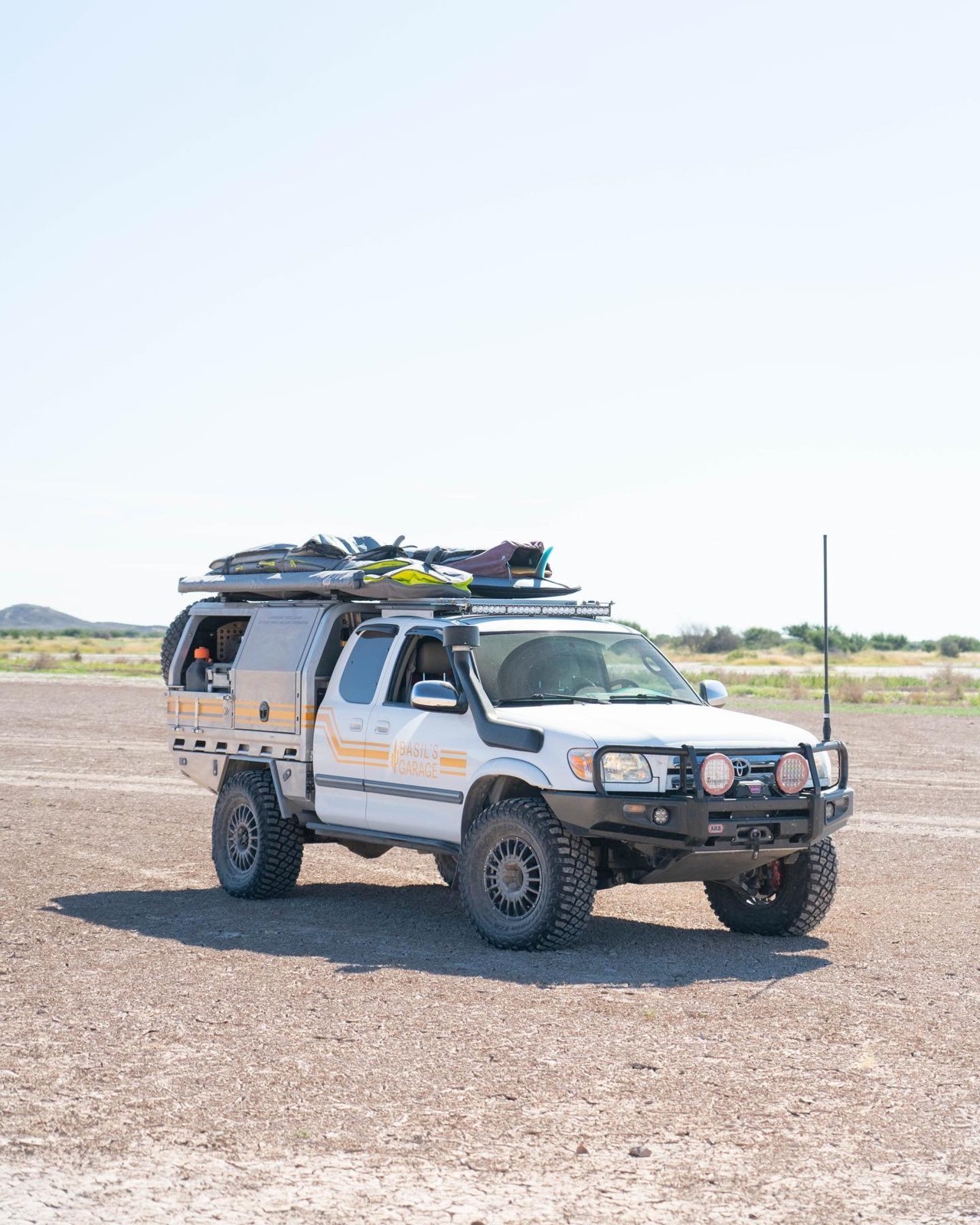

    Well, I figured it was time to introduce myself here and our shop truck.
    I'm Basil, the owner of Basil's Garage, a shop in San Diego. We've somehow made a name for ourselves in the FGT world and have been lucky enough to build many trucks for customers.
    Our shop truck, and my rig, is a 2005 Tundra. I bought this truck about 5 years ago with plans to build it to travel the Pan American Highway, which has not happened yet, but in the meantime, the build has evolved to my take on the perfect Baja surf exploration rig.
    To start, there's honestly not much factory Tundra left. Everything except for the Engine, Transmission, and steering has been modified in some massive way or is completely aftermarket.
    I'll save a few posts for details on the rig, its an ever-evolving project and I'll try and keep this thread updated.
    Here's a flat-out list of the modifications & truck
    • 2005 Toyota Tundra
    • Access Cab
    • Limited
    • 4x4
    Driveline
    • Factory Toyota 4.7 V8 engine & 5-speed transmission
    • FJ Cruiser transfer case with twin stick modification
    • Custom Oceanside Driveline rear drive shaft
    • CVJ high-angle front CV axles
    • Factory front differential. (4.88 gears, ARB air locker, ECGS needle bearing delete)
    • Custom-built East Coast Gear Supply Dana 60 rear axle. (4.88 gears, ARB air locker, 67” WMS, 35 spline chromoly axle shafts, 6 bolt Toyota lug pattern, full float hubs, 3/4 ton disc brakes, ARB diff cover)
    • Crown Performance braided stainless steel ARB air locker lines
    • GPS wheel speed sensor sending unit
    • Long-Tube headers
    Brakes
    • Powerbrake big brake kit with PB05 upgraded pads
    • Crown Performance custom braided brake lines front and rear
    • Wilwood rear brake proportioning valve
    • 3/4 ton rear disc brakes
    • Toyota T100 Master cylinder & brake booster
    Wheels & Tires
    • BF Goodrich 35x12.5R17 KM3 tires
    • Custom-made BRAID wheels (17x7.5, 0mm offset, 108mm hub bore, beadlock-B system, Antracite)
    • APEX Designs rapid air up/down valve stems
    Miscellaneous Truck
    • 100 series land cruiser snorkel
    • Centri pre-filter
    • Custom aluminum 24-gallon auxiliary fuel cell
    • ARB Twin air compressor & locker manifolds
    • Custom side exit exhaust with Magnaflow muffler
    Armor / Barwork / Gussets
    • Modified Tacoma ARB front bumper (WARN ZEON 10, Master Pull synthetic line)
    • Custom rear hitch
    • White Knuckle off-road rock sliders
    • Custom aluminum front skid plate
    • Shock tower gussets
    • Spindle gussets
    • Cam tab gussets
    • Fully boxed frame & gusseted cross members
    • Additional cross member above rear axle
    • Gusseted steering rack mounts
    Front Suspension
    • Arizona Desert Racing 2.5” coilovers with resis, adjusters, and 700lb coils
    • Speciality Control products upper control arms
    • Solo Motorsports factory length lower Control arms
    • Speciality Control products 1.5” travel hydraulic bump stops
    • 10” limit straps
    Rear Suspension
    • Arizona Desert Racing 2.5” rear shocks with resis & adjusters
    • Speciality Control products 3” travel hydraulic bump stops
    • Custom Alcan leaf springs for 3” of lift & 2500lbs of additional weight
    • East coast gear supply Dana 60 u-bolt flip kit
    • Archive garage Hammer hangers & shackles
    • Currie Enterprises Antirock sway bar
    • 16” limit straps
    Truck electronics
    • Custom Off-Grid Engineering dual battery system
    • REDARC BCDC1225
    • REDARC load disconnect (for self-jump start)
    • DC-Power 270A alternator & big three wire upgrade
    • 2x Group 35 Full-Throttle batteries
    • Switch-Pros 9100
    • Kenwood TM-D710 radio
    • Alamosa dual-band radio antenna
    • Baja Designs 40” ONX6+ light bar
    • Baja Designs Squadron SAE fog lights
    • Baja Designs rock lights
    • ARB Intensity V2 LED driving lights
    • Baja Designs RTL-M 3rd brake light
    • iPad Mini for nav/music
    • REDARC tow pro
    Tray & Canopy
    • MITS Alloy 1870mm x 2050mm x 850mm tray
    • MITS Alloy 1870mm x 1000mm x 850mm canopy
    • MITS Alloy stubby sideboards
    • MITS Alloy 30L headboard water tank
    • MITS Alloy fenders & under tray toolboxes
    • MITS Alloy ladder rack
    • MITS Alloy under tray drawer
    • MITS Alloy rear ladder
    • Custom rear canvas walls
    • Custom twin spare tire mounts
    • Custom interior fit out (single drawer w/slide out table, pull out vertical pantry, battery cover, oven mount)
    • Go Fast Campers V2 pass through XL Roof Top Tent
    • ARB Awning
    • L-Track tie-downs throughout tray & canopy
    Canopy electronics
    • REDARC REVISION system w/ 3x screens
    • REDARC Manager 30
    • REDARC BCDC1250
    • REDARC 3000W inverter
    • RELiON 300ah low temp lithium battery
    • REDARC 240W folding solar blanket
    • REDARC water tank level sensors
    • 1500w Induction cooktop
    • Nespresso coffee machine
    • Starlink 12v satellite internet
    • 12v camp oven
    • ARB Elements fridge/freezer
    • Exterior solar input Anderson SB50 connector
    • Exterior 12v Anderson SB50 connectors
    • 110v outlets
    • USB/USB-C outlets
    • Hardkorr lights on canopy doors
    • Interior Baja Designs rock light
    • Exterior cargo area Baja Designs S1'
