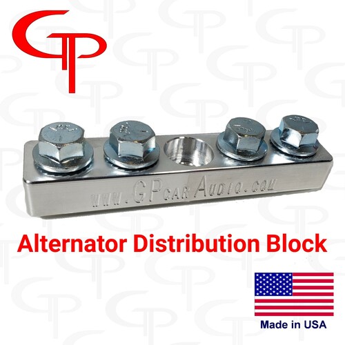

    The stock battery cables use ring connectors, so instead of removing them and going zero gauge cable, and redoing everything, I just added another 4 gauge cable from battery to the alt by changing my terminals to ones that will accommodate several ring connectors without having a fricking 1/2" stack of connectors.
    For the alt stud I went with an alt distributor block. They were not cheap though. These I got from GP Car Audio.

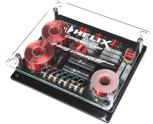

    That s a good point. I ll wait and see how my builder addresses that, or if he even does. I can think of a few ways to solve it though if he doesn t. A covered battery box, or even a piece of plexi glass like they use for passive crossovers would do the trick.
