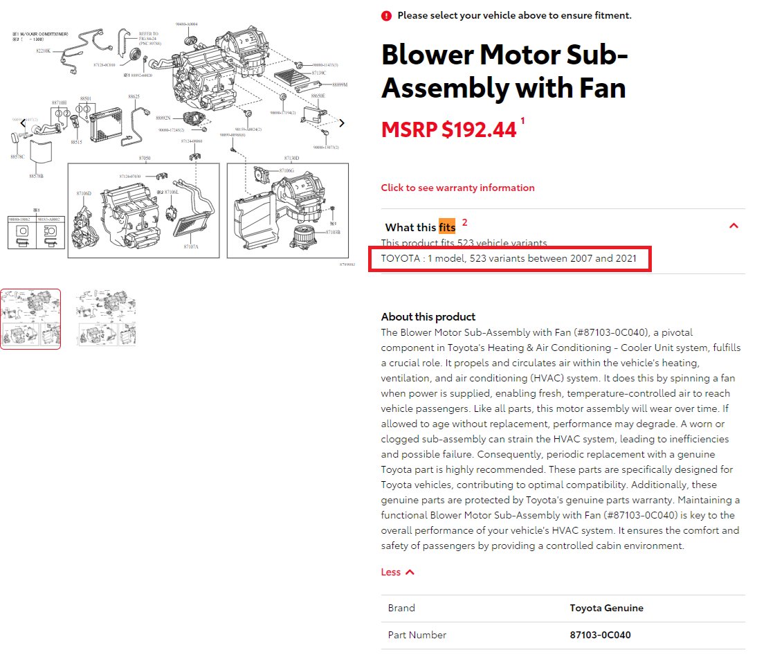

    This listing seems to suggest it fits a wide array of Toyota from '05+, including Avalon, Highlander, T4R, Tundra, etc. and even a Dodge (Dodge Journey? Never heard of one)
    https://www.ebay.com/itm/233799730154
    Maybe I'll get an aftermarket unit just to play. IIRC, it's only like two/three bolts to drop the blower out, install should be 5-10 mins. I'll compare connectors later. That thread suggests a slight improvement in speed for the '07+, so I wouldn't doubt if it was better than our '00-'06. It's just a matter of fitment.

    I get the sneaky suspicion 2005/2006 may've been a crossover year where they changed the part (Murphy's Law).

    You installed the Tundra replacement, or the Land Cruiser replacement, as an upgrade?
    I realize OEM is more $$, but the fact you've had to buy one in a fraction of the time the OEM lasted should tell you all you need to know. All that cheap Chinese bullshit sold thru scAmazon and fleaBay is ultimate polluting the ground for the future generations, all to delay a hit to the wallet. We're ultimately polluting to save a buck, and expecting the next generations to pay for it. Just buy OEM and it'll last another 15yrs, just like the original.

    When I replaced mine at about 200K, the dealer OEM blower was cheaper than the aftermarket part at NAPA.

    The larger Dual Cab Blower fits in my 04 AC so I use that one which really pays off in the summer and winter.
    And yes, the online Toyota blower is cheaper than aftermarket.

    Hold up, the dc/sequoia blower is larger & fits? Color me interested.

    Yeah, apparently the Land Cruiser or LX470 motor does also? And may blow more air. See link in reply #7 above.

    Rockautos spec sheet says the blower fan diameter is larger on the ac, but doesnt give the depth.
    DC=5.75 x 2.5
    AC=5.866 x ??
