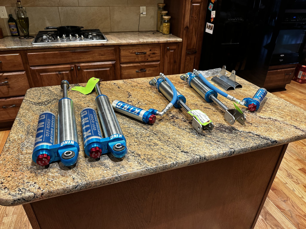

    Any performance shock will need to be rebuilt at some point. The good thing is you can rebuild them...and it is rather easy to do.
    Check out Colton @memario1214 with hot shot off-road. That guy usually has good deals all year long.
    You can also check out Ben with Filthy Offroad in Denver. This is where I get my shocks from, but we have a long standing relationship.
    If you ever need help rebuilding them, I'm just south of you.

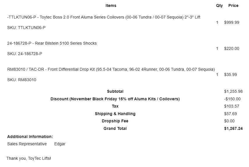

    TTLKTUN06-P - Toytec Boss 2.0 Front Aluma Series Coilovers (00-06 Tundra / 00-07 Sequoia) 2"-3" Lift
    That's what my receipt shows. Screencap below of my order.
    I am running aftermarket LCA (SCP, but the Eibach-boxed version for 30% less $$$, I got them for a little over $500). I bought during BF in 2022, 15% off. Got the diff drop under logic, "what the hell, alredy spending $1k, what's $35 more?" but in hindsight, waste of money. And honestly, I hope the 6112s I have ride better than the Elka/Toytec, I dunno if it's just the 700lb spring or what, but ride is pretty damn stiff IMHO. Hindsight 20/20, I'd have gone with a 650lb spring if I did it all over again.

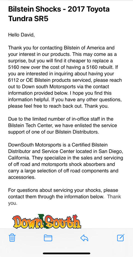

    A quick update. The shop had it all buttoned back up by the time we were talking, so I didn't feel any real rush to make a decision yesterday. It seemed extra squeaky on the way to work, of course.
    This morning I am leaning towards getting a pair of 5100 and sticking them in while I deal with the warranty.
    I read another post that was complaining about the turn around time because Bilstein rebuilt yours and sent them back. Instead of providing another set quickly or in prior to receiving your pair. I don't have a clue.
    Right on. Thanks for the info! Have you sold yours yet?
