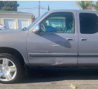

    I recently bought my '06 Tundra SR5 4WD with 165k miles. I love the thing. It is mechanically in excellent shape, and drives perfect. This is my first truck but also my first vehicle, as I have always lived in a city/in a country with great trains and no need for a car. I bought it with some fairly mild body damage, but recently took it four-wheeling (with no knowledge of what I was doing, and yes, I appreciate I am an idiot lol), and slid off a hill into a tree. I'll post pictures of when I bought it and now. I picked up a new driver's side fender off Amazon but need to get it painted. I bought the truck for $11.6k for a dealer. Does that sound like a reasonable deal?
    Here's what I need help with:
    1) Bodyshop said it's very difficult to paint metallic paint to make it fit the rest of the vehicle, so they want to do pretty much the entire driver's side which would cost $1500 (please note that I'm pretty much broke right now so this is just not an option. Is it even true what they said about the metallic paint? They are definitely trying to rip me off.
    2) Is the other body damage even worth fixing? I bought myself a fix-a-dent repair kit with a glue gun and a suction cup dent fixer. Have so far tried the suction cup (hasn't really worked but didn't try for long), but not the fix-a-dent. I'm considering buying a set of special rubber/wooden mallets too. Has anyone ever done this/had any luck with it any of this home dent repair stuff? Again, I'm broke so I need cheap options. Also, if body work geeks could give me an estimate on cost of repair of the various parts to the cost of repair on the whole truck I'd be so grateful. Also, do you think the damage on my truck is possible to fix by myself?
    3) I want to lift and modify my truck a bit too, has anyone got any advice on this? Should I fix the bodywork before I add the lift kit/levelling kit or do you think that the body work doesn't matter as much? What would your preference be? I plan to use this truck as a daily driver but also as my camping/adventure rig, so I'd definitely like to modify it at some point.
    4) Levelling kit or lift kit? I don't want it ridiculously high, just a little bit. I heard levelling kits are more just for show than actually helpful off-road. Can anyone comment on this?
    Thanks in advance for all your help, I appreciate this is a very long post.
    Dan
    damage1.jpg damage2.jpg Would you repair it?
    Tempest and NUDRAT like this.

    Dan I used to use cirtifit when repairing my older Toyotas, sometimes it's easier to replace a panel then repairing.

    If you plan in wheeling it more, dont paint it. Just touch up the bare metal and roll with it

    1) I believe metallic paint can be a little more difficult to match, but a good shop should be able to get close enough without painting the whole side. Sounds like a rip-off...
    2&3) You originally purchased a vehicle with prior damage, so I’d imagine absolute perfection isn’t a must. So I’d guess you could fix it as best you can and drive the hell out of it and still be happy.
    3&4) If you are going to really off-road it, do it right. Get some quality shocks and set it where you like. Spacer lifts are not going to give you any other benefit than the look. Your ride and function will actually suffer with a spacer type leveling kit.

    It’s common to have to paint and blend into the panels on either side of the replaced/repaired panel, especially on older vehicles. Otherwise your one door will stand out from the others. The brand new paint will not match your existing paint that has fading and wear from over the years. It’s labor intensive removing, prepping, painting, and re-installing all these pieces, hence the cost invovoled. Not a rip-off. It just is what it is.

    So you bought a truck with some character lines & took it out off roading. I'd say fix it yourself to good enough if you'll be going off-road again. If you want a pretty truck, pay the pro. Is that fender a bolt on? I've never looked. If it's bolt on, remove the lights, remove the fender & just reshape it from the backside so it doesn't interfere with the door. Touch up any raw metal, buff, polish, & hit the trails! Oh - better tires! And you can sell the replacement fender. Good luck.
