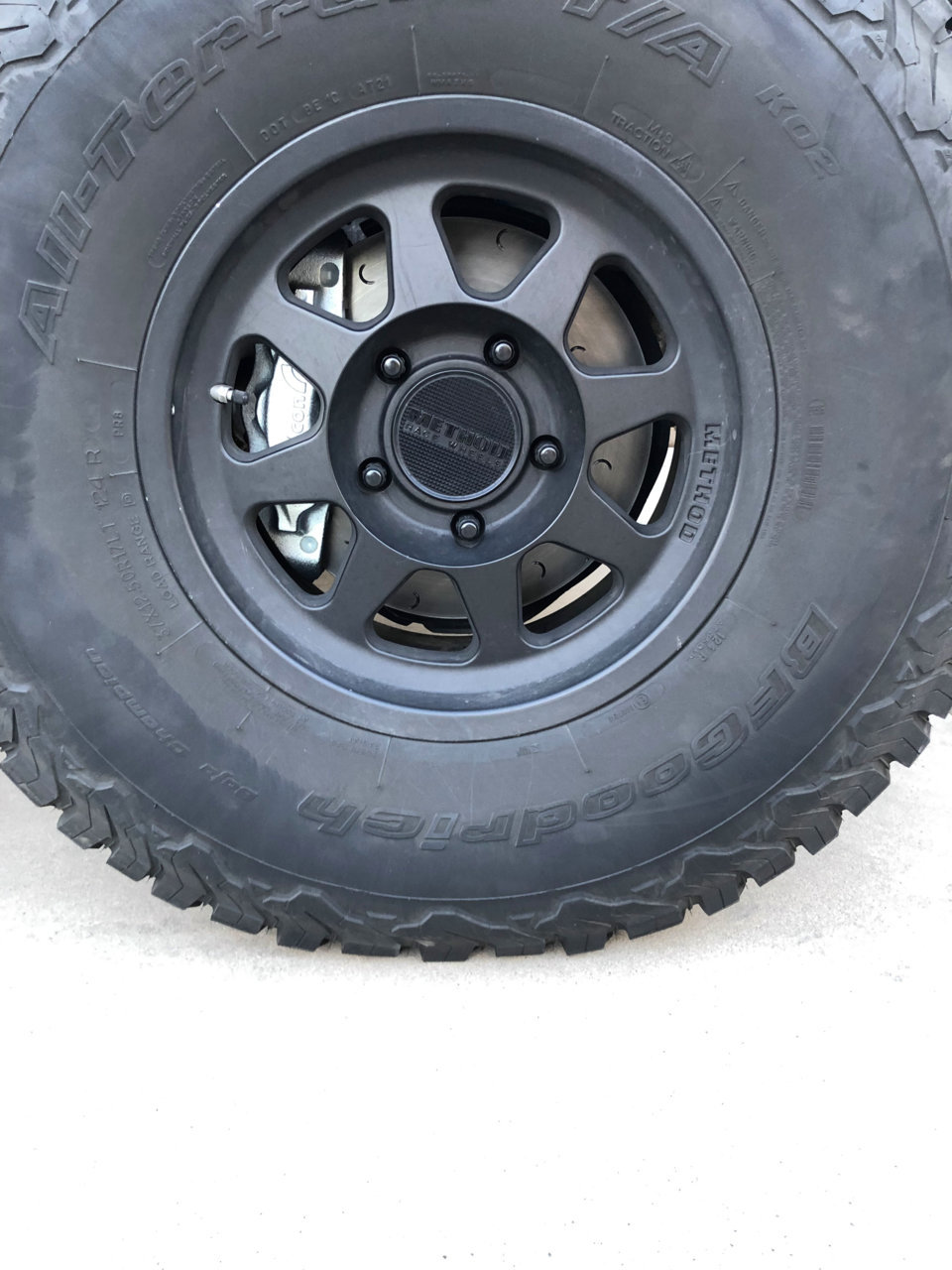

    I would say what are your needs/how do you use the truck. If OEM worked fine then stick with that. If you're looking for slightly better performance than ebc yellows with stop tech rotors. If ultimate braking is needed the of course a full aftermarket BBK is where it's at.

    Pics of front and rear
    pman9003, Seafury and HulkSmurf14 like this.

    [​IMG] [​IMG] [​IMG]
    Rotated my tires this weekend and took a look at the brakes. The pads definitely look like they need replacement, but what do you think about the rotors? These are the original rotors with 90,000 miles on them. Not warped at all. Go ahead and replace them when I do the brakes, will they last a little longer and save the money?

    I'd replace them.
