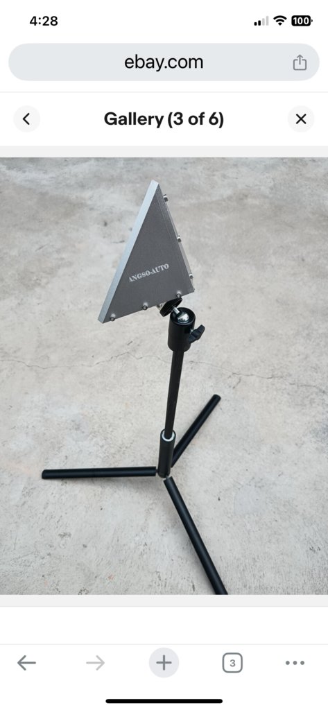

    I was able to solve all my issues by recalibrating the front sensor behind the Toyota emblem. Took all of 5 minutes. You located anywhere in So Cal?

    Did the sa
    I purchased this and was able to calibrate and set the parameters back to 0. I did buy the SAS from the dealer though. I had one from Ebay and couldn't get it to reset but that was before I purchased this device and ran through the procedures that I posted earlier. It's pretty simple and straight forward. I paid $360 for the SAS
