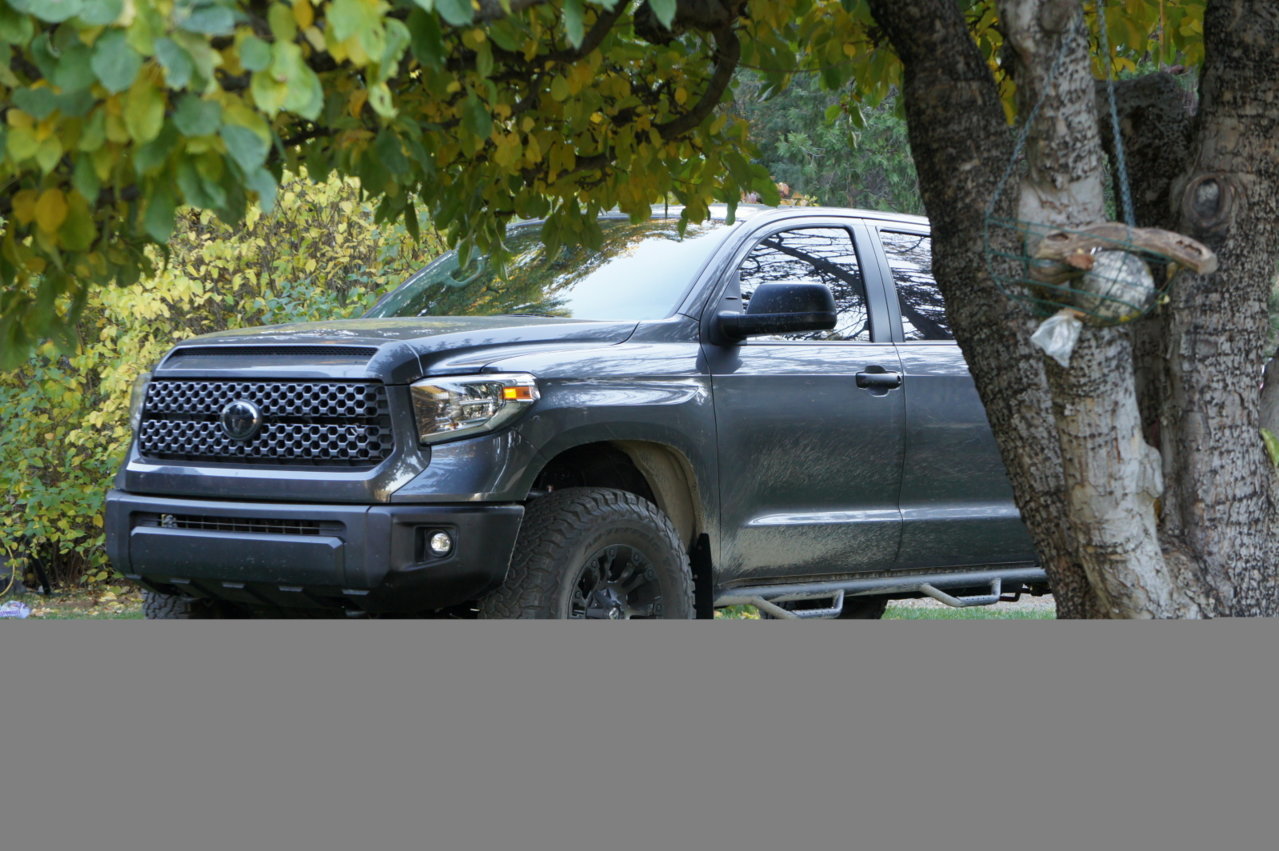

    Jul 20, 2016
    #3927
    1,020
    Tom
    Wilmington, NC
    White 2016 Tundra DC ltd
    Nope, will cause spontaneous combustion
    Moon Puppy and Midnighttaco08 like this.
  3. Nov 3, 2018 at 1:54 PM
    silverhack
    silverhack New Member
    Sep 18, 2017
    #9737
    622
    Sacramento, CA
    2018 CrewMax Inferno
    Yes you can put the Pro grill on the 2018, there is lots of discussion bout this. Try the Search function. My recommendation is to buy the Jomax Customs bracket to relocate the radar sensor. I have used that one, the Ares original bracket and the 3D printed bracket and Jomax worked the best for me.
    LVLDUP18 and 619Tundra like this.
  4. Nov 3, 2018 at 1:57 PM
    Larmand
    Larmand SSEM #6
    Dec 30, 2017
    #11835
    4,158
    Lucas
    Fort Worth, TX
    Welcome to the party!!
    Yes search around plenty of info in here about that
  5. Nov 3, 2018 at 2:27 PM
    Y0TA PR0
    Y0TA PR0 Oil & Gas
    Jan 24, 2016
    #2519
    24,432
    Rafael
    2017 TRD PRO
    WELCOME
    GNTundra likes this.
  6. Nov 3, 2018 at 4:41 PM
    29,504
    Welcome from NY.
    Yes you can but you have to relocate the sensor.
  7. Nov 3, 2018 at 4:53 PM
    ARES
    ARES ARES Fabrications
    Dec 13, 2017
    #11492
    450
    God Bless America
    2018 Tundra TRD Cement
    To avoid any warranty issues and for the best OEM design and function I would Highly recommend going with the 2019 TRD Pro grille. It is a more costly route but in my honest opinion it looks better and it has the OEM relocation for the PCS Radar. Some guys have had great success with there dealers allowing them to install it without warranty issue.
    1Sikyota, gosolo and KnuckleHD like this.
  8. Nov 3, 2018 at 5:33 PM
    Vizsla
    Vizsla 2 = 2.5
    Jul 14, 2016
    #3867
    2,674
    You could but there are a few caveats. There is a company that has been booted from here watching, and changing up things in cadence with information available, so this will be simple, not interested in helping them by proxy. The sensor and round garnish(these are actually called a radome) are designed to work together like peanut butter and jelly, and is a pretty ideal scenario. The 2019 Pro sensor is a different part number, as it is different internally to work with the Pro garnish and is a more difficult scenario. Toyota spent a good bit on the Pro to make it very small, and it incorporates at least 2 visible specialized design features that make it work. The garnishes are insanely priced for a reason, a lot going on there. There is a huge flaw in putting the sensor behind the old Pro grill, and another lesser flaw as well, again not helping the ignorant. I have also seen claims the radar is just adaptive cruise, it is not and cannot be in a single camera system. Now the nasty, so whoever is selling an off road only safety system mod for brand new trucks is an idiot by default, how many off road only Tundras you know of? Now after that, you release all rights, responsibilities against the seller, and assume all risk while being informed it could be big trouble to purchase. When you install that on your vehicle and drive it, you signed off on knowing it’s for off road use only, released acknowledgment that the mod is not DOT legal and can malfunction, it’s called gross negligence on your part. Front end collision if your at fault, regardless if the modded systems fault, will get you, and the company that sold sued beyond belief. Finally you will see the claim that it needs recalibrated, and then passes a test, it will in that controlled environment, but it cannot account for the scenarios that will cause false readings. Toyota says do not touch it, no wiggle room, and they are alerting dealers not to touch any vehicle with TSS mods. This has nothing to do with @ARES , he is a very talented fabricator that hopefully pursues more viable products for our trucks. Weigh it out, talk to your dealer. If you read this whole thing thanks, the whole system is proprietary, this represents 2 years of difficult to find research.
  9. Nov 3, 2018 at 7:19 PM
    Vizsla
    Vizsla 2 = 2.5
    Jul 14, 2016
    #3867
    2,674
    Mods, I am fine with insults, let them stand so the rest can see.
    Yes, 2” in front stock height in rear.
    OR18TRD[QUOTED] likes this.
  10. Nov 3, 2018 at 7:25 PM
    Vizsla
    Vizsla 2 = 2.5
    Jul 14, 2016
    #3867
    2,674
    You are fine with your grill, the system can be recalibrated perfectly fine on lifted trucks. Mine is lifted and recalibrated. Works perfect.
    Darson Layne and OR18TRD[QUOTED] like this.
  11. Nov 3, 2018 at 7:38 PM
    KnuckleHD
    KnuckleHD New Member
    Apr 25, 2018
    #14770
    1,405
    2018 Tundra CM Limited- Cement
    First of all, welcome from San Diego. Everything mentioned above is true and great advice for anyone willing to listen. The short answer is yes you can. Should you? Well I’d recommend doing the research and making your own informed decision.
  12. Nov 3, 2018 at 8:50 PM
    Vizsla
    Vizsla 2 = 2.5
    Jul 14, 2016
    #3867
    2,674
    Very well said my friend! Sometimes my inner nerd makes things confusing. Wow:bowdown:, truck looks soo nice, little :jellydance: of the mirror caps and handles, did you add those?
    KnuckleHD[QUOTED] likes this.
  13. Nov 4, 2018 at 7:01 AM
    Heatonrx
    Heatonrx New Member
    Nov 14, 2017
    #10977
    170
    Didn't need a relocation bracket or recalibration of the sensor. Not one error and I love the look. Good luck. Do it!
  14. Nov 4, 2018 at 7:11 AM
    TunderStorm
    TunderStorm New Member
    Sep 12, 2018
    #19335
    242
    Michael
    2018 TRD SR5 CM MGM +
    - Toytec/Eibach 3/1.5 + TC UCAs - Fuel Vapor 18x9+20 w/BFG KO2 35’s - TRD sway bar - Go Rhino nerf bars - badge delete - Bakflip MX4 - ESP storage - Rockford Fosgate 10’s +++ - TRD shift knob - Weathertech front mats - Escort 360 hardwired - Window tint Future mods: N-Fab M-RDS front bumper w/40” Black Series RC Lightbar
    That looks awesome.
    OP, as you can see, people are doing it.
    Have you considered paint matching your front end? That’s what I did and it looks a ton better. Haven’t done the bumper yet. I think the 2018 honeycomb is BA looking so just kept it

  15. Nov 4, 2018 at 9:15 AM
    Phishindude
    Phishindude New Member
    Oct 8, 2018
    #20327
    66
    That looks sweet!
