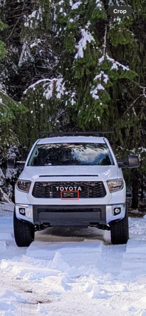

    This is where my TSS sensor is, you think the bumper won’t interfere with it?

    You said you have the honeycomb grille which is not that one, that is referred to the Pro grille.
    Yeah, I can see your concern. I do not know and will let someone else comment on if it will interfere.
