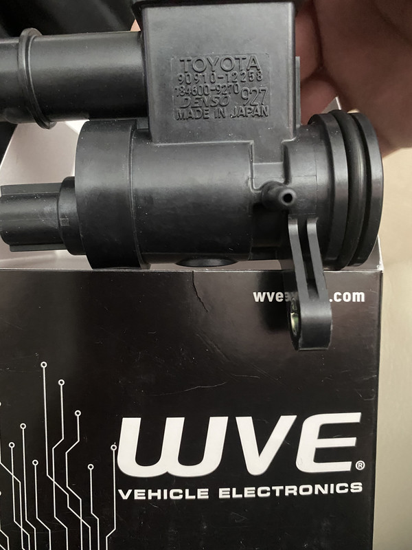

    For anyone looking to replace one, the cheapest canister vent valve I found that was OEM is the WVE one from rock auto.

    Ok rookie question: how do you remove the hose going into the purge valve?? The one with the weird plastic clip

    2004 DC SR5
    Two picks on either side to lift up the tabs. Took me a good 5-10 minutes to get that sucker off
