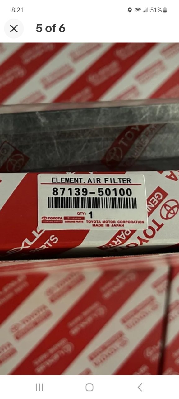

    A tip for anyone that cares...use the cabin filter from the Land Cruiser, it's the same as the Tundras.
    It is impregnated with charcoal and filters out smells as well as, the rodents don't like it so they won't make a nest out of it.

    I believe 87139-50100 is the part number for the charcoal version. 87139-07020 is the regular version.
