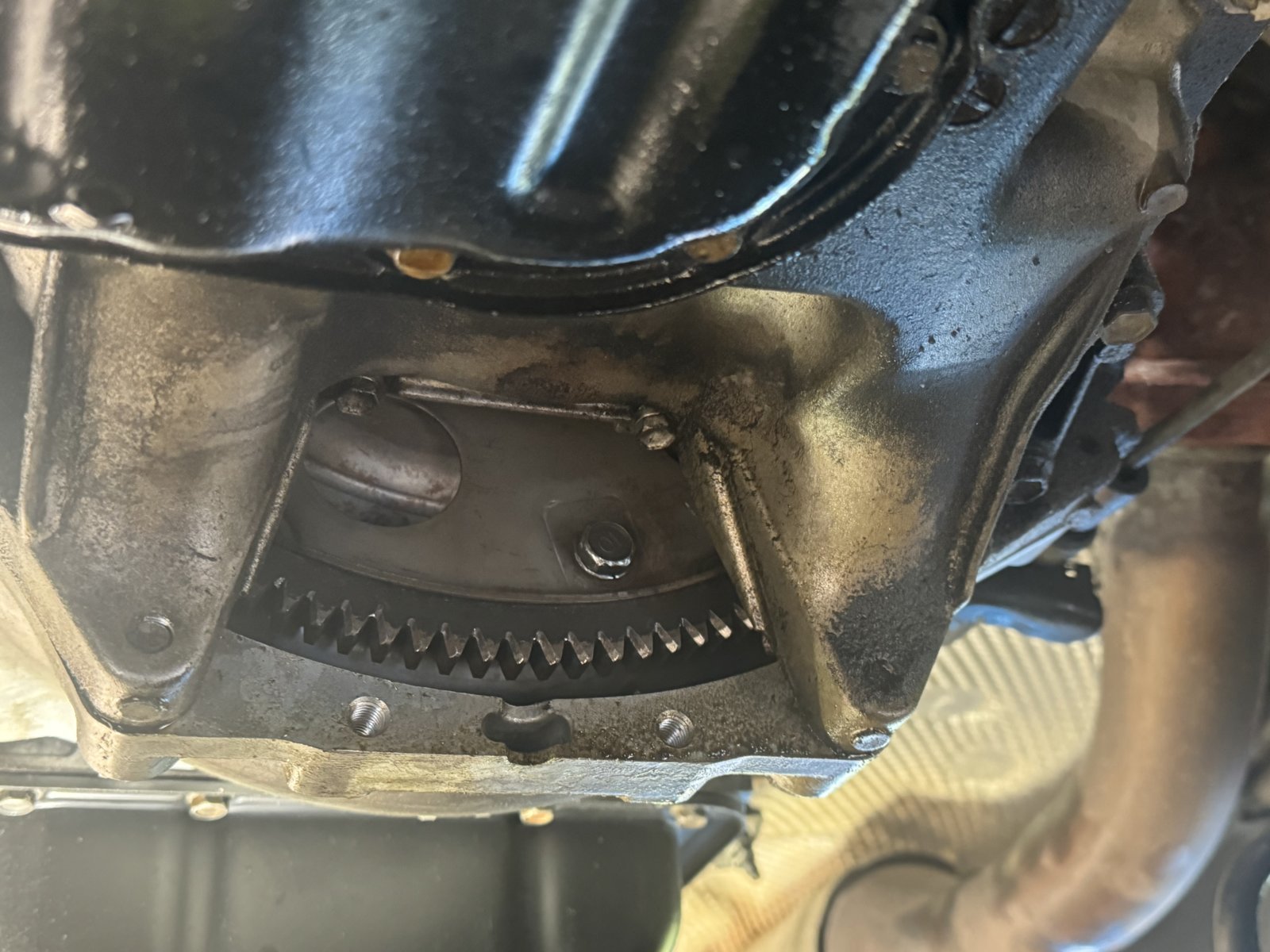

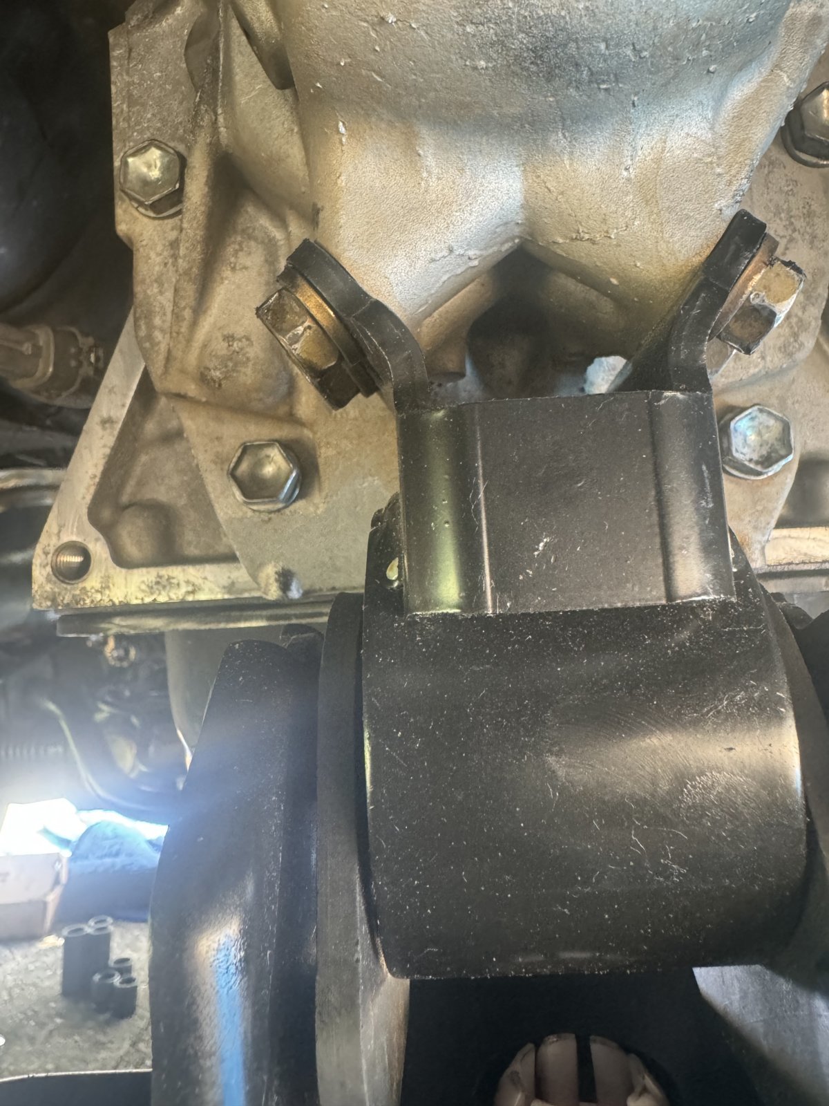

    Can anyone find anything wrong in these pictures?
    from the underside of the truck, having recently had the transmission rebuilt:
    UCA bushing:
    LCA bushings:
    New transmission mount, does this look normal? Seems to be a lot of space for it to slide around, but I've got no experience with this

    Never mind - does not appear to have O-rings. Job is complete and there appears to be no leaking
    as to the pictures, I'll ask around. But I already know the little cover on the transmission was probably left off by the transmission shop.
