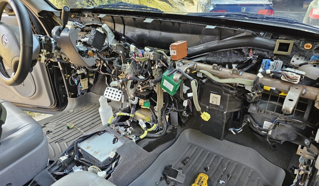

    Does anyone have experience with changing the dashboard on a first gen?

    Yup. Down to frame and back wall twice. But I don't have any step-by-step go-by. Tips:
    First step, turn your steering wheel far to the side to expose the small Allen fasteners in the column. Do this before you disconnect the battery. You'll have to take the steering wheel off. (Borrow a puller free from Auto Zone, O'Reilly's, whichever is your local auto parts store).
    Begin disassembly by manipulating the air vents in the stereo surround, inside are two fasteners, one each side. Once those are out, you'll be able to gently pull out the surround. Go slowly and pay attention... any time you feel resistance, stop and look for a fastener to remove.
    I think I recall most of the actual weight fastening bolts are 8's (?) and there's only maybe 10 of them(?)
    BIGGEST TIP:
    Place every fastener in one of the cup holders in your center console (or place a small box on each floorboard, same/same)... if you remove a fastener from driver's side of center, put it in that cup holder; passenger side, to that cup holder.
    DASH REASSEMBLY FOR DUMMIES:
    Take photos of each step at disassembly. You'll learn as you go and, for anyone more "visual learner" than I am (99% population), you may not need the pics to remember how it all goes back together again. But if you are challenged in this kind of thinking... or you'll leave the dash disassembled for awhile and forget... pics are a huge help.
    Anyway. I have no idea what your actual question might have been. Lol. I hope something I wrote is the answer. Good luck!

    Thinking about the cab swap and so want to move the dash and pedals to keep the bluegrey color

    Because I determined the housing for the uber-silly drink holder that wouldn't really support a cup, was the perfect place for my comms radio base. But it's not accessible from the front. I got all the way down to the frame, and removed the big dash piece, to discover that a bolt mounted from the back forward is what held the thin metal box frame I sought. And also, that it wasn't actually perfect; the little box frame I wanted to put the radio base into needed some modification.
    So I took that as a template, and my radio base, to Bruce, with a request that he fabricate a radio mount. He agreed to do it, but life happens at its own speed and weeks passed, and I putting the truck back together for a trail run I had previously committed to.
    Very soon after that trail run, Bruce called to tell me my mount was ready. :angrygirl:
    I do think it's the perfect place for a comms radio mount. Super secure when hucking or whooping. And that cup holder was super lame.

    @Bmktw2 Don't skip this if you've already got it apart.
