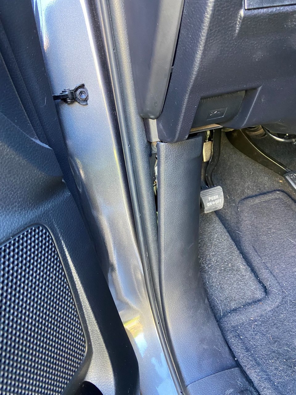

    What's the secret method to getting this panel to clip back in? I can see the parts behind that need to line up, but no matter which way I hold my mouth, it's doesn't stay.

    If you take it off there should be a white pin that slips into a pocket on the panel that gets pushed into the hole on the frame. It is a bitch as it took me a couple tries as well.

    remove the upper white pin and connect it into the trim piece. The lower one can stay in the body of the truck.
    Line things up and skip the lower part of the trim over the pin then pop the upper pin into the hole in the body.

    The only thing that might be in the way may be a white ground wire, just move it off to the side and you should be able to slide it right in and hear a pop sound. That’s when it has seated.

    I'm sure you probably have already figured out how to get the kick panel back on by now but for anyone else that maybe wondering how to do this it isn't hard. The key is that there are two plastic clipy things that attach to the back of the kick panel that often get left in the body of the truck when removing the kick panel. Those have to be pried out of the body and put back on the kick panel. They fit into slots in the panel and are angled forward. It is important that they are put back in facing the right direction, that being forward. Once you have the clippy things attached to the kick panel it will go back on with minimal effort. I have had mine off many times while installing a new sound system in my Tundra.

    That was the key! Appreciate it. Once you have the clips on the panel, it slots right on.

    I know this is an old post but I didn’t want to create a new thread for a simple question.
    Does anyone have the part number for the clips?

    Thanks but I am looking for the white angled plugs that connect the lower panel as seen in post 11.
