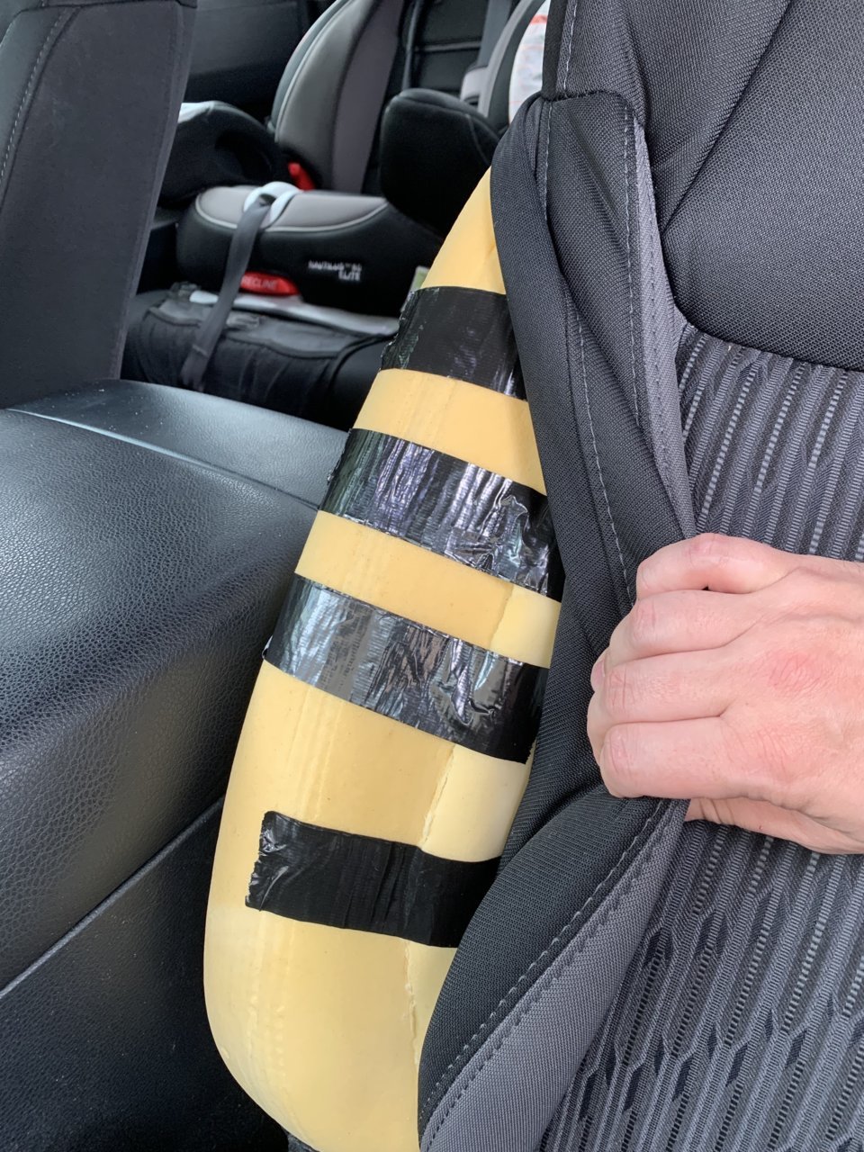

    Finally got to this. I used the video above posted by @1lowlife. You only need to remove the 2 straps under the back of the seat and unzip the side with the issue (video @ 12:37).
    Once I got in I saw that @Bl^ckTuNdra14 and @Ellis_McPickle were both correct. The metal I was feeling was the leading edge of the frame. You can see how it cut right through the foam. The only thing I can think of is my kids pulling on this portion of the seat when getting in/out. Our driveway is on a slope so they constantly grab the seat.
    To prevent this from happening again, I used some high density foam I had from a craft store, cut a large rectangle from it, and shoved it behind that metal edge.
    My thumb is on the piece of new foam below. My hope was to provide additional support behind the actual seat foam to prevent it from ripping again. Size was approx 12x4x4 inches.
    Once the foam was in place, I used some duct tape over the metal edge of frame to hopefully help prevent it from cutting through again. Not perfect but should be ok.
    Next I used some 3M multipurpose adhesive to glue the foam back together. To prevent overspray, I sprayed some in a container and used a paintbrush to apply. Again, it isn't perfect.
    I used some more tape to reinforce the seam and prevent the side/flank piece from pulling over. once it tore, it wants to rotate towards the console. Not sure how much this part will help.
    Finally I went to the back of the seat and taped the back of the foam to the back to the seat frame.
    I can feel the added support in that side now but it otherwise came out well.

    Nice repair.

    Looks like Gorilla tape to me..
    That sh!t is awesome..
    Hope you got it fixed...
