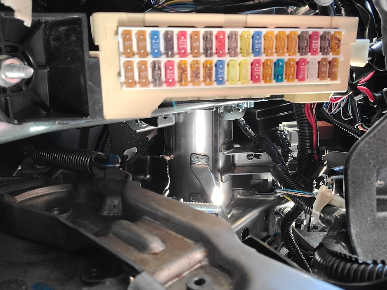

    Need badly
    • Picture of a populated 2018 interior fuse panel
    • Need to identify the interior fuse for ACC

    Does this help?

    Hi, Thanks. Yes it is nice what is the year? One question what way is up?

    2018. Bottom of pic is closest to firewall.

    Would it be too much to see the cover off and all those sexy naked fuses exposed??

    Same orientation as previous. Also, your cover may be located where mine is now. Down inside the kick panel lol. It popped off and shot straight down the opening in the top of it.

    Thank you so much. You did more than can be expected. It is helpful and I totally copied the fuse placement. No help at all.
