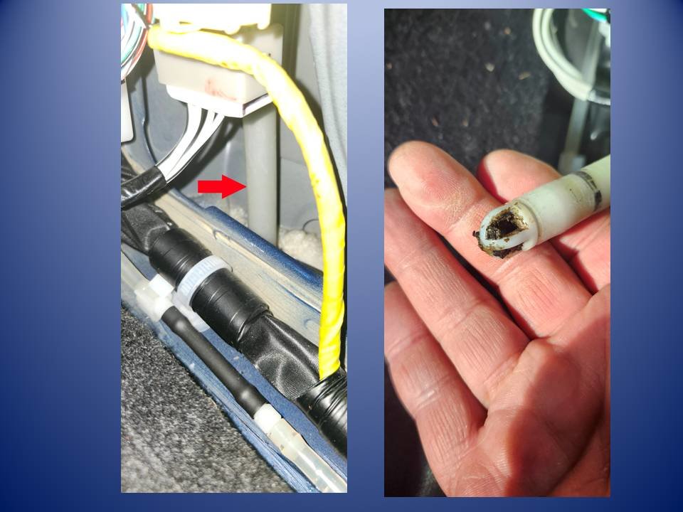

    So as another update - hopefully last.
    I did research and the symptoms pointed to the moonroof drain. But when I pour water down from the moonroof tray, I see water exiting below.
    I removed the passenger side panel where you access the drain tube and this is what I found at the end of the drain tube.
    So it was still letting some water trickle through. The event we had caused it to back up, electronic components in that area like the ECM experienced dampness leading to the stall and no start and the blown fuse.
    If your vehicle is subject to outdoor conditions I highly recommended you check your drain.
