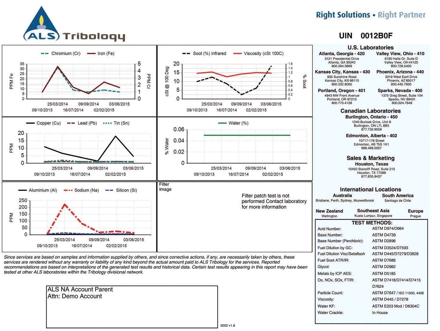

    Has this been brought up before? I had never heard of it, but one of my board members uses a service to analyze his oil. He takes a sample, mails it in, and they send a report listing levels of certain metals and other contaminants that will tell you whether you've got excessive wear from different engine components, based on what metals or compounds they find. You can track this over time with their charts.
    I guess they cater to business fleet vehicles, but also serve individual customers.

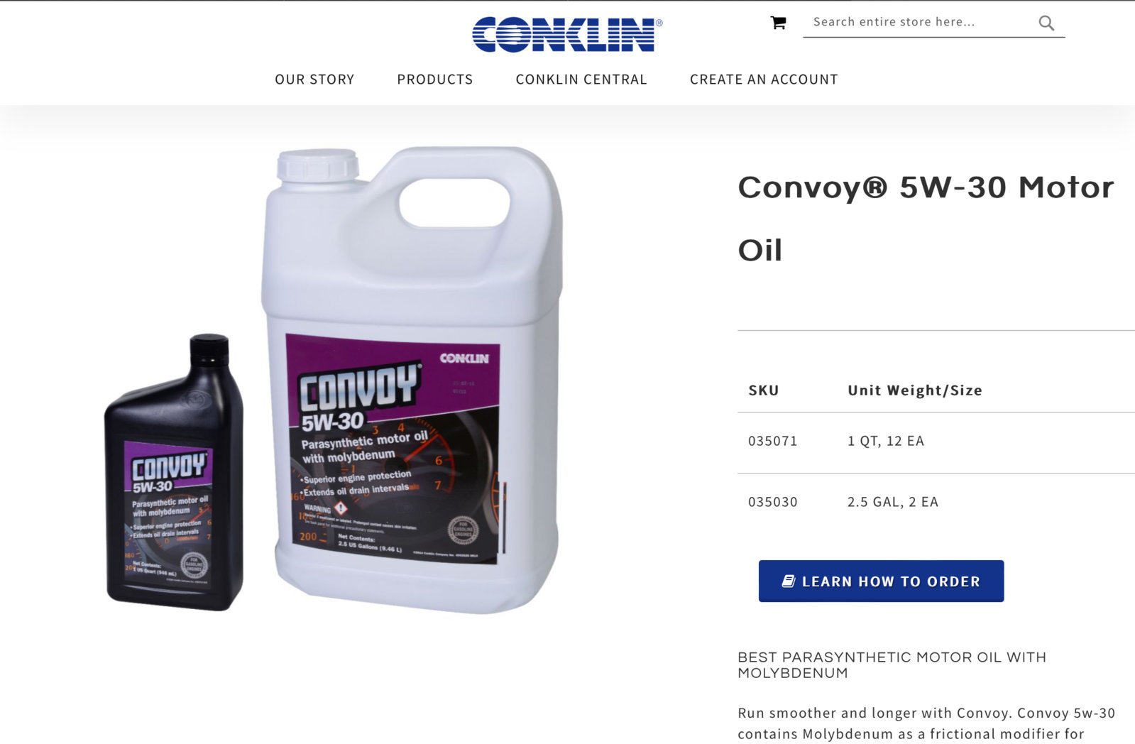

    And separate but related, he changes his oil once a year, or every 15,000 miles, with Convoy oil. He replaces the oil filter every 5,000 miles. Never heard of this, but he swears by it.

    I'm curious how fleets use this info. Or actually how common it is for big rigs or passenger-size business fleets to use oil analysis. A solution looking for a problem? Or is the data actionable? I don't know. The idea is intriguing, but that doesn't mean it's worthwhile.

    VERY familiar with this, Caterpillar offers the same service. You can buy the test tubes and paperwork at the service counter. You can send in ANY oil sample from ANYTHING. Caterpillar does not actually do the testing, the samples are sent to a third party lab and you get a print out and email with digital prints like you posted. I have bought the kit from Caterpillar and tested everything on my machines, ATVs, vehicles, ect.
    I found out about this in 2012, i bought a Cat D6M from a broker with a brand new Caterpillar long block with receipts, brand new undercarriage, chains, pads, rollers, sprockets and all, but had a slipping transmission. The machine had 3 hours on it since the complete overhaul, and the broker apparently took it in needing some work and thought he was going to put an engine in it and sell it for a real profit but afterwards ended up with slipping trans and took a bath on it rather than sink more money into it.
    I bought it knowing i might have to put a trans in it, already priced it, about $15k at the time. I went to Cat and asked them all about it and the service guy suggested i check the oil and see whats in it, this model has wet clutches in the trans, its a fingertip control unit with wet clutches and if they were slipping they could test the oil and see what it was, how much of the clutches were in the oil ect. I bought one of the test kits i think it was only about $20 at the time and warmed the engine up, and siphoned some oil out and sent it off and waited. It took a few weeks but they sent back all sorts of info.
    1) trans was filled with hydraulic oil
    2) clutch material was minimal
    3) brass zinc ect ect all looked pretty normal
    This machine requires a specific 30w wet clutch oil with special friction modifiers, and whoever put the engine in, also likely drained the trans and unknowingly put hydraulic oil in it rather than the wet clutch oil. Likely a "do-all" diesel mechanic who wasnt well versed on the Caterpillar stuff. I contacted the cat guys and they recommended:

    Oil analysis is a very valuable tool, as it can let you know of issues before they show up. I used be responsible for the engines on several oil tankers. I was the one that initiated the oil testing program, after we failed a USCG inspection on a emergency generator set. We did the maintenance and corrective actions recommended by the analysis and we passed the inspection 30 days later and I secured a fulltime spot on the ship. Even if you change your oil every 5K the analysis can let you know when a head gasket is leaking or bearings are wearing quickly, or your driving like a Grandma and loading up the engine with carbon, etc.. But it is NOT cost effective for every oil change as it adds about 40-50 bucks to the cost. I used to have a ZR-1 Vette and did the oil analysis about once a year as that engine is about 30K to replace.

    Interestingly, he swears by the Convoy oil, partly because it's a synthetic blend, not fully synthetic, and contains molybdenum. Something about the molybdenum holding oil/lubrication on metal parts better, aiding in cold starts. Says in weather 40 degrees F below zero, tractors with molybdenum additive would start, those without wouldn't. I don't know. I didn't know enough to hammer him with follow up questions.
