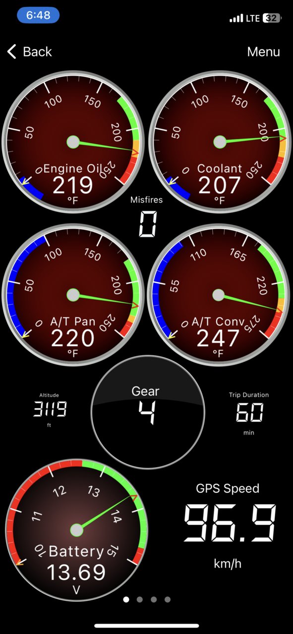

    Hmmm... S4 doesn't keep it locked on my truck.
    This was from the same drive. S4. If the torque converter was locked the display shows a green ring around the gear number

    This

    Does your truck have a custom tune?

    No. Considering one though.
    Now you guys have me questioning myself. I'll go for a ride tomorrow and test s4 lockups.

    My converter locks and unlocks in S4 depending on load. The trans temps stay lower in S4 though due to it being a 1:1 gear ratio with the engine speed so there isn’t much TC slip happening even unlocked which keeps fluid temps down.

    This could be the case - I just know from real world use the trans runs way cooler in S4.

    That matches my experience.
