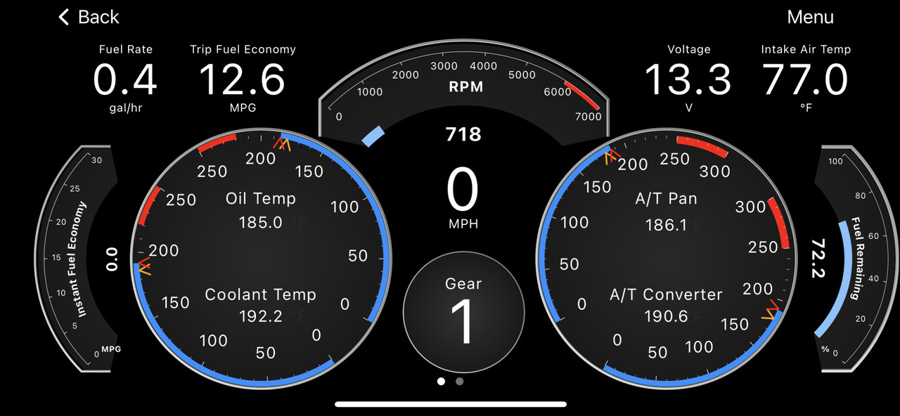

    About all I can share is a screenshot.
    The setup instructions are in the trans cooler kit thread. Its pretty intuitive and easy to play with. (and I'm 52 years old)

    I have android.
    Open the app...
    Click on "dashboard"...
    Click lower left corner (3 little dots)...
    Click"add dashboard"... (you will get blank slate)
    Click lower left corner again (3 little dots)...
    Click "add display"...
    Choose display type... (radial or digital)
    Pick your gauge style...
    When the next window pops up, click on the little arrow that says "vehicle speed"...
    Pick your data source (select PID's)
    Then choose what data you want to see on the gauge (vehicle speed / RPMs / coolant temp / etc)
    Click "OK" and you should have your first gauge to view.
    Repeat and personalize as needed.
