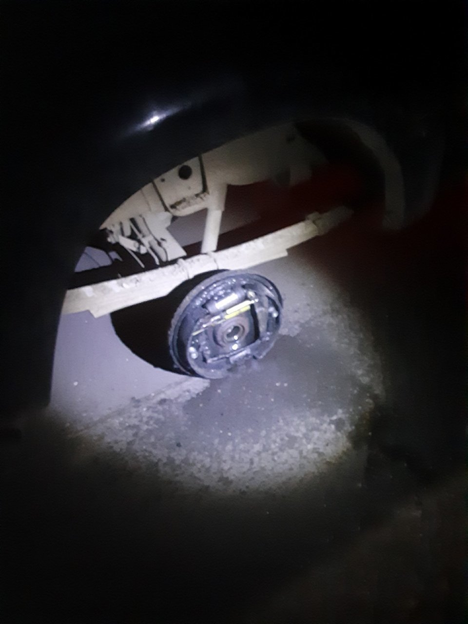

    While driving down the highway... my rear end dropped to the pavement.... and I see the passenger tire flying away.... as it broke off the axle. I had it towed to the nearest repair shop, that probable has minimal to rare tundra rear end axle/leaking seal/bearing jobs coming in, which is my thought because I had to speak up to clarify that the axle shafts are not the same length for a standard vs the Dbl crew cab and that they are finding it difficult to locate the parts needed to repair the truck. it’s in northern Michigan, my options were... limited .. none except to the closest and at this point not a option to flat bed tow it somewhere else that may have more tundra experience and the right press ect. There is a goal of getting the truck into the repair bay, and not end up with a shaft that is the wrong one and the issue of it occupying that bay... as apparently it’s some fiasco for this shop to pull it in with no tire as is.... let alone get back out while waiting for the right part.
    I was able to locate my tire/rim and the drum.
    What is definite.... and no confusion about is that the Rear Right Axle Shaft snapped .... and I will need a new one that comes with the additional Misc bearing seal ect.

    Only a little bit of axle shaft metal can be seen at the spot of separation.

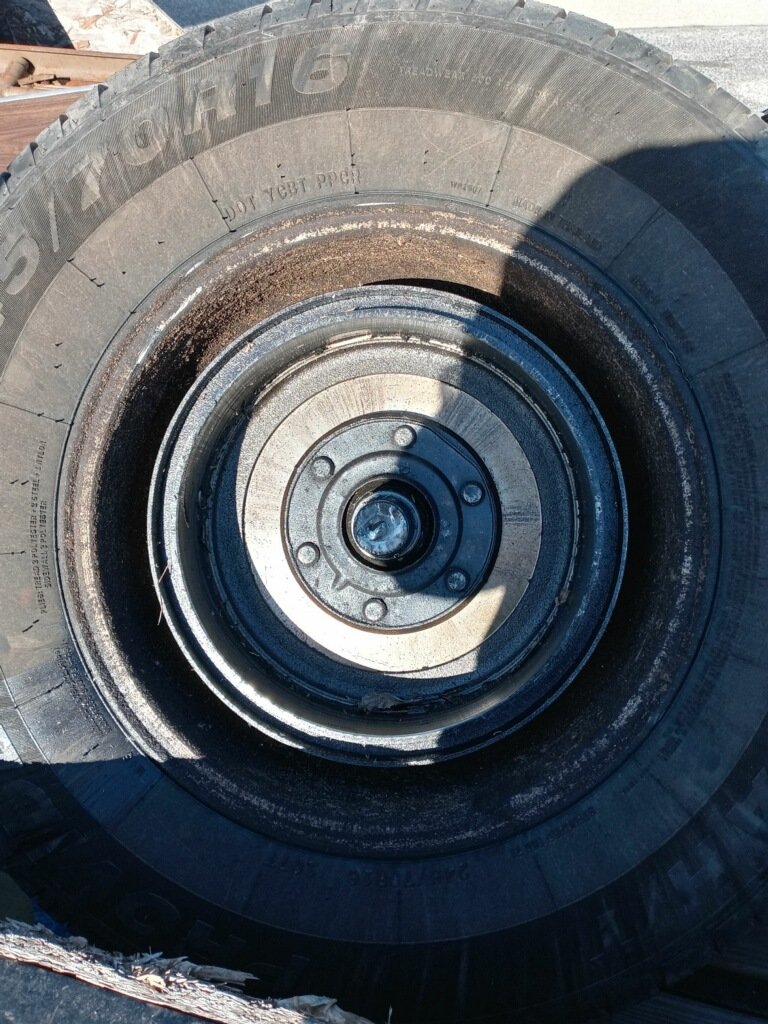

    And here is my tire
