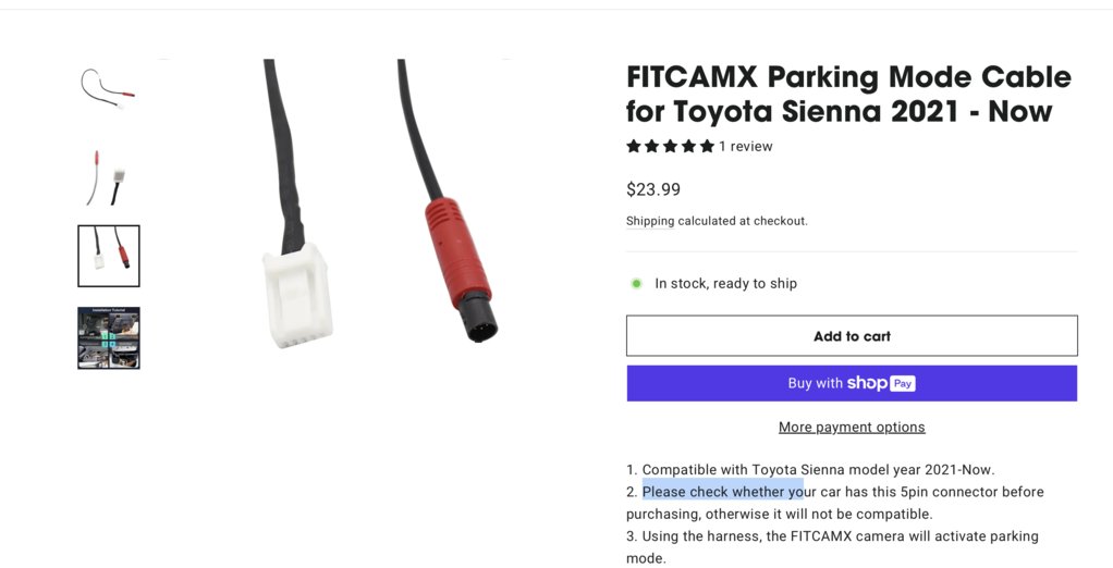

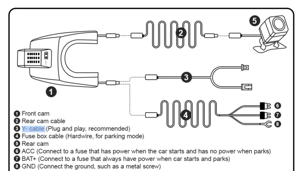

    Sorry - one more question: when using this cable, do you still need to utilize the "Y- cable" (#3) shipped with the dash cam OR do you just plug the (front) camera into the adapter and the (stock OEM) plug hidden in the headliner (used for the Toyota OEM dash cam install)?

    I ordered the sienna connector, it plugs into the oem dash cam connector. If you use the sienna connector you don’t need the Y harness.

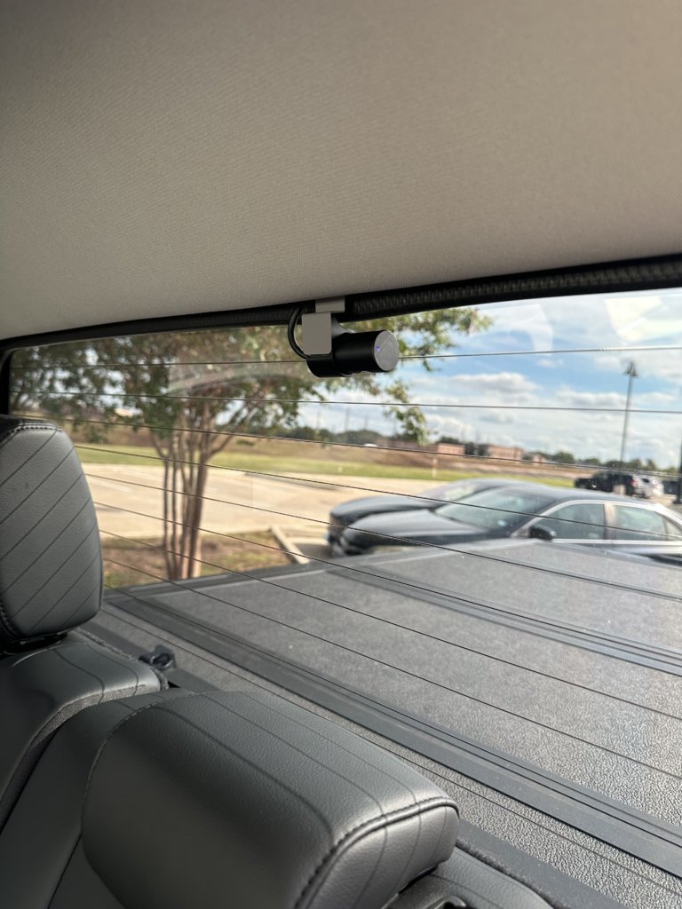

    Yea mine is a crewmax so the window rolls down. No issues at all. I have ordered a different bracelet since that picture though. It’s from the same place just ordered the 2in bracket the 1in makes the camera land right in front of the top defrost line. Not a big deal but I wanted to have the best video possible.

    here is the link. I have changed the bracket since that picture. I ordered another but this time I got the regular length, 2 inches. And opted for black color. The black bracket, black camera and weather stripping all kinda blend in and make it less noticeable.
    https://www.thedashcamstore.com/custom-folded-bracket-for-secondary-dashcam-lenses/
    forgot to mention why I got the longer bracket. The defroster line is right in the camera view. The longer bracket let me drop it down so it it between the defroster now.

    No. The extra harness, sienna harness plugs into the factory dashcam connector which has constant power and will allow parking mode. The T harness that comes with the FITCAMX doesn’t have constant power, so no parking mode. If you use the sienna harness then yes both cameras work with parking mode.
