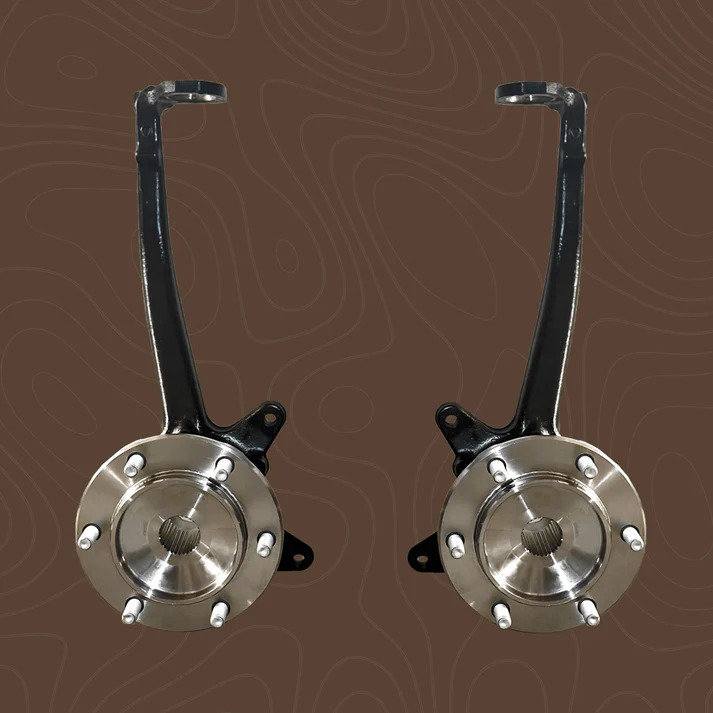

    Does anyone have any experience with this company (Fr33 Lance Fab) selling complete build spindles. $700 for a complete set isn't that bad and you can add gussets too. I know many would say just rebuild your set for cheaper. I prefer a straight swap not having to buy extra tools or go to shop.

    Completely assembled spindles/knuckles include:
    Koyo Japanese wheel bearings
    Japanese inner/outer seals
    New retaining clip
    New hub/wheel studs
    Fresh layer of high solids paint

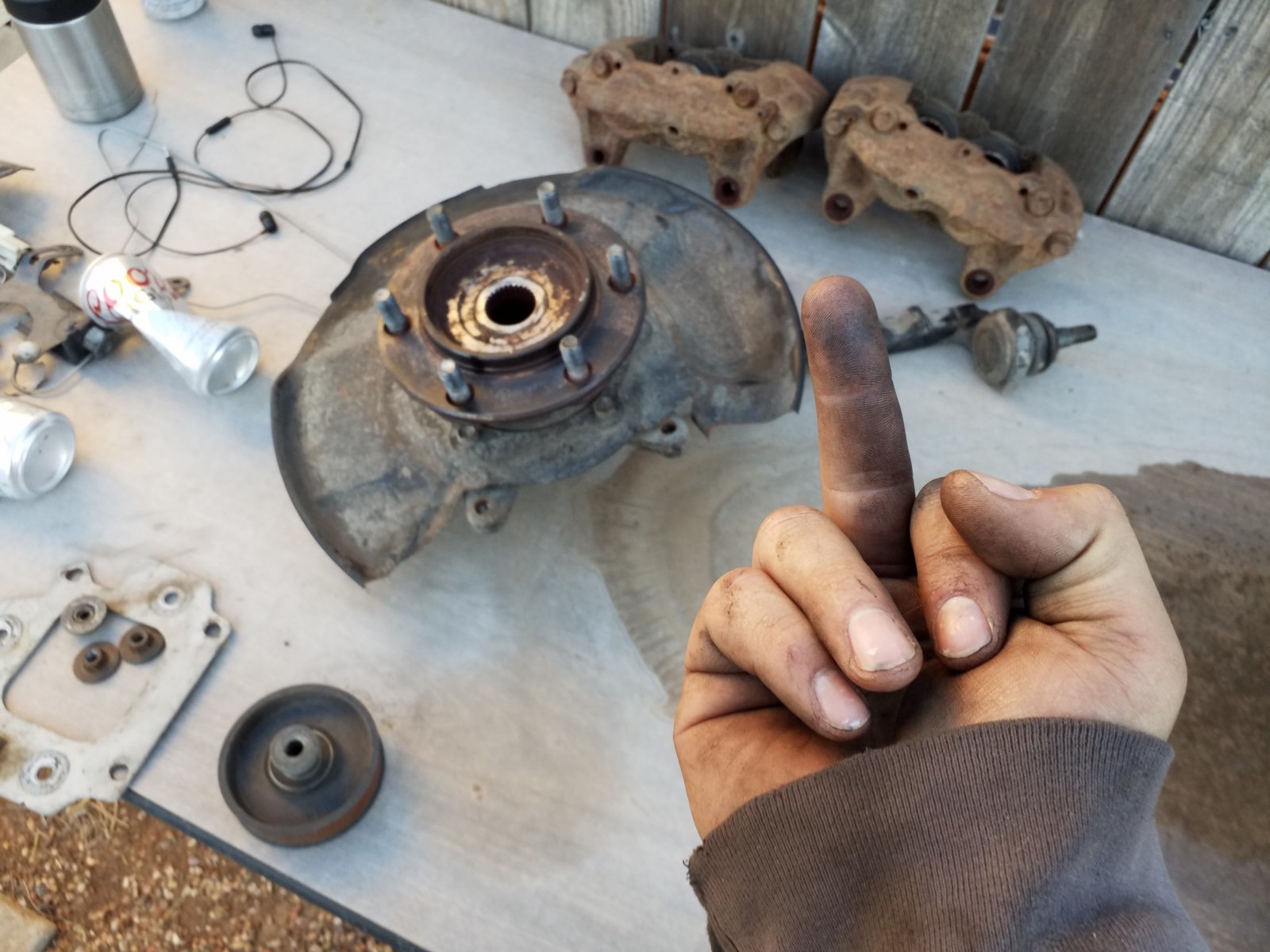

    In reality, mine was just a pain cause I couldn't get my UBJ to pop out, no matter how hard I hit it with my purse. I had to use a ball joint press in a really awkward way to pop it out.

    I’ve found that for myself, dust shields haven’t ever been critical on any of my builds. I also removed the dust shields from my tundra when i pressed in new bearing. It also makes it MUCH easier to hose off any mud off the brakes.
    I thought about welding on spindle gussets to my spindles when i had them disassembled. I did a lot of internet research beforehand, and found out that it COMPLETELY changes the dynamics of installing the upper ball joint when there’s a spindle gusset in the way. So i passed on installing them. I feel as though i made the correct choice for my truck. I have no problems if anyone else choses to go the opposite route for their build.
