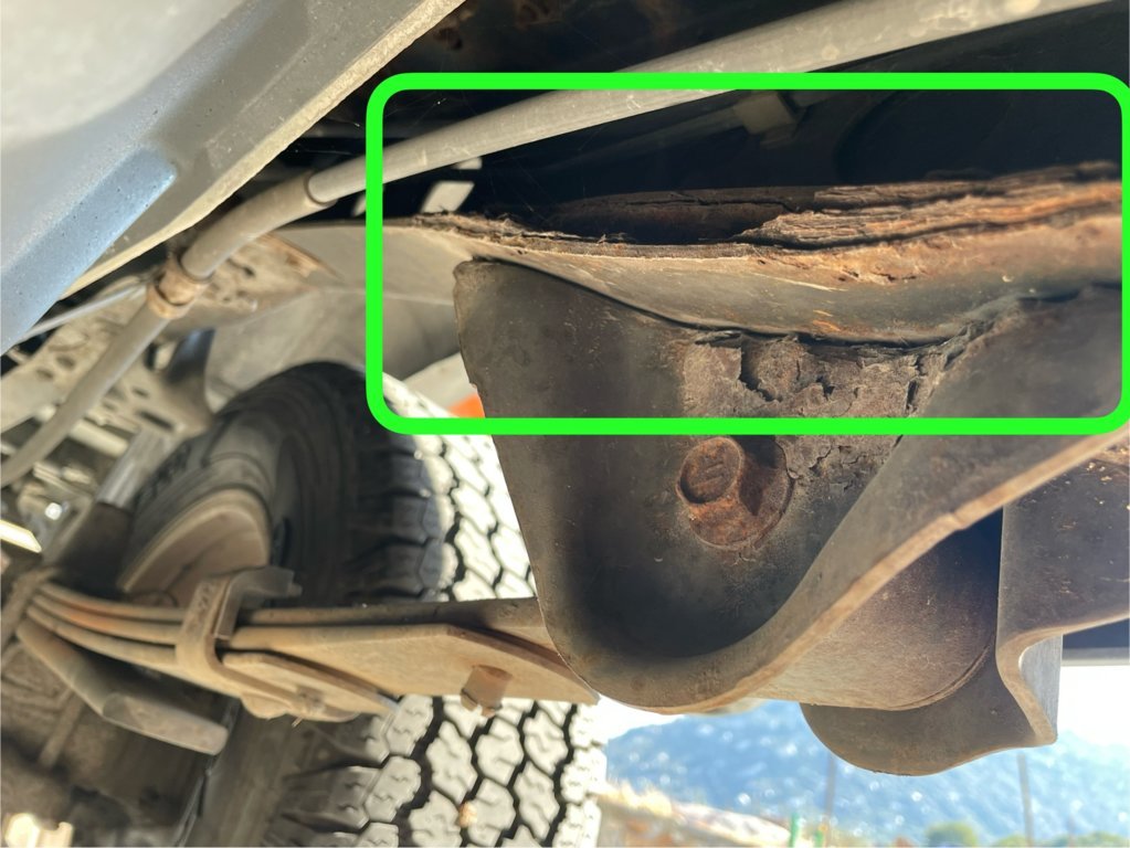

    Im debating going that route, I’m gonna have my shop who specializes in these Toyota 4x4’s give me their opinion on Monday. I guess I’m just a bit turned off by the whole thing since I just got the truck and I missed these things on inspection, along with a mechanic I took it to in the area where I purchased it who said he’d have no issue buying it. Additionally some sections on the outside frame were definitely painted over and I’m concerned it’s worse than appears (though luckily most of the frame doesn’t appear to be painted over).

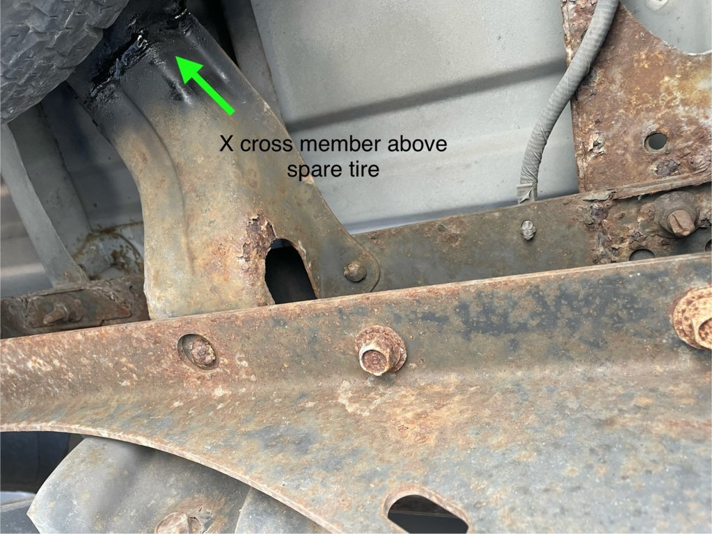

    Really the rest of the frame apart from the X cross member above the spare seems fine. Even that cross member appears fine but it looks like some patch or reinforcement material was applied at weak points. I even blasted other Tundra forums with a ton of under carriage photos and the comment consensus is it’s nothing to worry about but I didn’t highlight these specific areas. I’m a bit bummed because apart from this it’s perfect and I even just bought all new suspension and a new stereo to put in.
    What’s your opinion based on these photos? Worth saving or should I just sell it and start fresh? First few are where it’s the worst, the rest are showing the current state of everything else which appears fine. Thanks a bunch for the reply.

    Obviously the delaminated part by the shackle hanger is bad and needs repair, but the rest isn't the worst. Needs to be descaled and treated though.
    Jack McCarthy and shawn474 like this.

    As far as gen 1s, that's pretty rust free. Keep it!

    Yeah I was definitely planning on hitting everything with a descaler and wire brush then applying some rust reformer/epoxy/top coat regardless. I’m just concerned now that I spotted that area by the leaf mount that there’s other serious areas I missed. Glad you don’t think it’s the worse though… would you personally keep it? I would get that area fixed for sure if I do.

    If the delamination is isolated to that area, and I already owned it? You bet. I would inspect to make sure no other areas needed attention. If that's the worst, I would treat the frame and fix the hanger location.

    Agreed - if that delamination is isolated that’s not bad at all. But you have to mitigate it or it will spread like cancer. Just like others - if the delamination is not systemic and can be remediated in that area the rest doesn’t look bad at all.

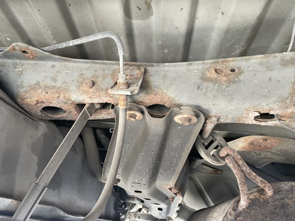

    That's almost a museum piece compared to some of the other members' frames on here... mine included.

    I read that whole thing a few weeks prior to actually looking at this truck and this area is definitely mentioned. I should’ve read it again as I inspected it or before as I didn’t check this area. My main take away was bring a ball peen hammer and make sure everything is solid with no holes which I did do. Could maybe be worth adding to check specifically for delaminating in this area?
    How bad do you think I have it? Here’s a shot of the other passenger side which looks a bit better than the driver side.
