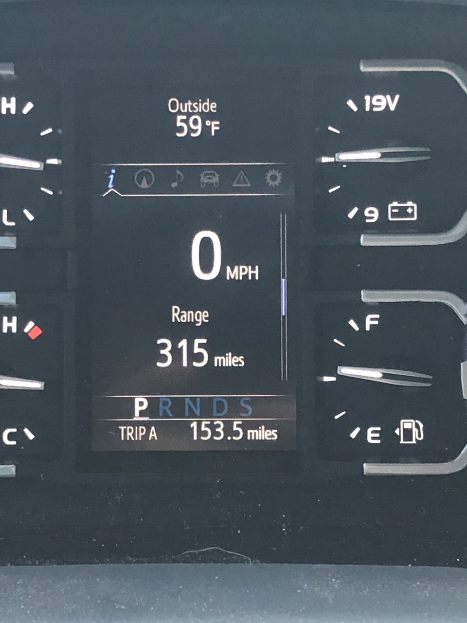

    I recently d/c’d my battery to clean the terminals. I know this throws the computer off when it comes to tank range bc the computer has to relearn everything, however, I recently filled my tank to full and reset my trip stick after filling. As you can see I’m approaching half a tank and my trip stick is only showing a meager 115 miles, which means I’ll have only gotten roughly 250 miles out of this full tank by the time I’m empty. (Yes I know we have 6-8 gal reserve when the light comes on) but I’ve been consistently getting 350-380 miles out of a full tank (from full to until E-light comes on)
    As you can see my range is showing 324 miles (obviously this is wrong if I’m almost at half a tank, but this is proof of the computer having to “re-learn.”)
    It’s as if my fuel gauge is off…
    FWIW I did just move up to 35” tires, but I shouldn’t have lost 100 miles on a tank. (Computer still shows 10-12mpg)
    Does the computer also have to “re-learn” the fuel gauge?
    Would the speedo being off by ~5mph now with larger tires ALSO throw the odo or fuel gauge off?
    Thoughts?

    I’d give it a few more fill ups. Mine does the same thing when I disconnect the battery. Normally it shows 410 DTE but goes up to 600+ when I disconnect the battery. It takes it a few tanks to relearn. 115 for a half tank would be low, even for 35s.
    Fill it up now and see how much it takes. I think mine takes about 15 gallons at half a tank. If it’s much less, then your gauge might be off.

    Yeah I’m clear the tank range or distance to empty takes some driving to normalize, my concern is the fuel gauge being “off”

    Fuek gauge operates ona direct line to the fuel tank and sender. The sender is a variable resistor that increase the resistance on the direct line as the fuel level drops. If can only be off if your float is stuck or broken, not from disconnecting the battery.
    Speedometer, Odometer, Trip will all be off as they are calibrated to the wheel speed sensors and stocks tire size. The ABS/Stability control ecu monitors the pulses from the wheel speed sensors and calculates a speed, distance moved and sends these values to the cluster. Fastest way to check this is with a free speed/distance app on your phone. It will use GPS to show your actual speed and distance moved.
    Avg. MPG and Range calculations are all done inside the cluster. The engine ecu sends it a signal of fuel burned at a certain rate, it then does the math to get the MPG. Most people report it takes some driving to get all this values to balance back out after resetting them.

    Thanks for all the responses. After refilling the tank once after this post was made, I am now inclined to believe the fuel gauge also has to “re-learn” just like the tank range does. I am attaching 3 pics. One is the original picture showing a measley 115 miles at nearly half a tank. Second picture is showing the needle at nearly the same position, however, this time I attained 159 miles. In between pics I refilled the tank from
    Half back to full. 3rd pic is showing I’ve attained 175 miles at a half tank, which will hopefully put me at, or close to 350 miles on a full tank (trip stick at 350 miles when gas light comes on and range is 0). Also to be clear, the driving I did between fill ups (the 115 mile trip stick and 159 mile trip stick) I drove with the same driving behavior and same city driving. Also, as you can see the tank range is still re-learning. The stock days of 450 miles+ on a tank was nice, but since then I’ve upgraded my truck substantially to include 35x12.50 tires, steel bumper, steel skids, sliders, camper shell (all the heavy stuff lol).
