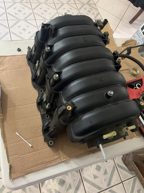

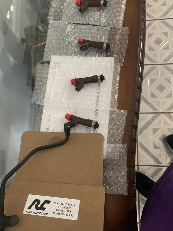

    Hello everyone
    Vehicle: 2006 DC 4.7
    Recently bought some aftermarket Fuel injectors from a reputable company, I won't mention the name because I don't want any negative press for them, I have nothing against them, and this is not a bashing post.
    That out of the way.
    So, I've installed the injectors and re installed them several times now, every time I've made sure there's no O-ring that is pinched and everything is seated correctly, I have done this now maybe 8-9 times. They sent me another set and the same thing is happening.
    So, what IS happening?
    If I crank the vehicle after sitting for around 30 minutes or more it starts as if it's being starved of fuel, takes about 4-5 seconds to fire up, before with the Toyota injectors, it literally fires up in an instant, just like it would have done when it came off the factory floor.
    If I crank it after maybe 2-3 minutes after the truck has been turned off, it will fire up, but maybe take 1-2 seconds (like it's not struggling as much) this time as opposed to almost instant as described before.
    I believe it probably something to do with the smaller O-rings which go into the fuel rail, as this is what I've been told gives me the symptoms I'm experiencing.
    Any help would be greatly appreciated.

    can you just get your oem ones cleaned?, it’s about 20-25$ an injector and they give you new o-rings. That’s what I did
    any chance there is an old o-ring on the rail stopping it from going all the way in. I took out my intake to do mine because i didn’t know better hahahaha
