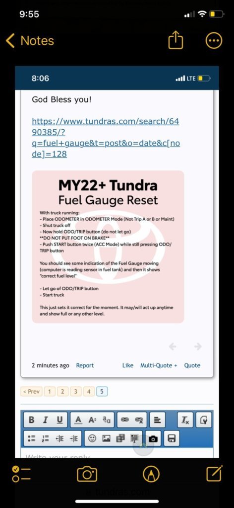

    Anyone have any other remedy for the fuel issue these POS trucks have? Where it’s showing full knowing it isn’t.
    Mine has done it multiple times in the last few months. The shutting off in drive doesn’t work. Only thing that does work is filling it up every time it has the issue.

    Have you tried this? I couldn't get the shut off in drive procedure to work either.

    Why can't the computer just do this every time we turn it back on?
