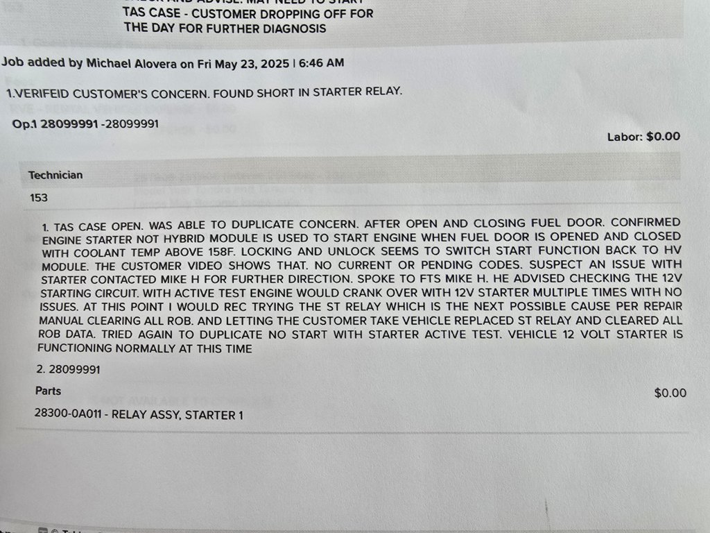

    Is anyone having fueling issues with their 25 Tundra Pro?
    When I get gas, I park the truck at the pumps, pop the gas door, and then close the driver door. I uncap and pump gas. After getting gas, I get back inside and try to start the truck, the electronics only turn on. No gas engine. I have to get out, lock the door, get back in to start the engine. This issue has been replicated multiple times. I have taken the truck to toyota, who said they couldnt replicate the problem. So I recorded the issue on the gopro below. If anyone has any answers, or helpful tips, that would be greatly appreciated. Mind you, this happens even if I lock or unlock the door after popping the gas door.

    Since the hybrid’s starter only engages on the first start after refueling, bad battery or starter circuit? Dealer issue for sure.
    chaztizer and tublas[QUOTED][OP] like this.

    I’d bet this is it. The hybrids are designed to use their standard 12V battery and starter under the conditions you describe. Not sure why it wouldn’t throw a code, but I did not hear the characteristic “starter” sound mine exhibits on the start just after getting fuel. This is reportedly designed as a way of “checking” and keeping everything moving in the starter and should work when the truck is at operating temp and the fuel door was opened. Since yours doesn’t do it on the one start attempt after getting fuel, it probably reverts to the normal hybrid high voltage start on that second ignition attempt as it does on every other start up. I’d try to talk to someone knowledgeable at your dealer and see if they can work it up for this.

    Hmm. Thanks, I'll give them a call.
