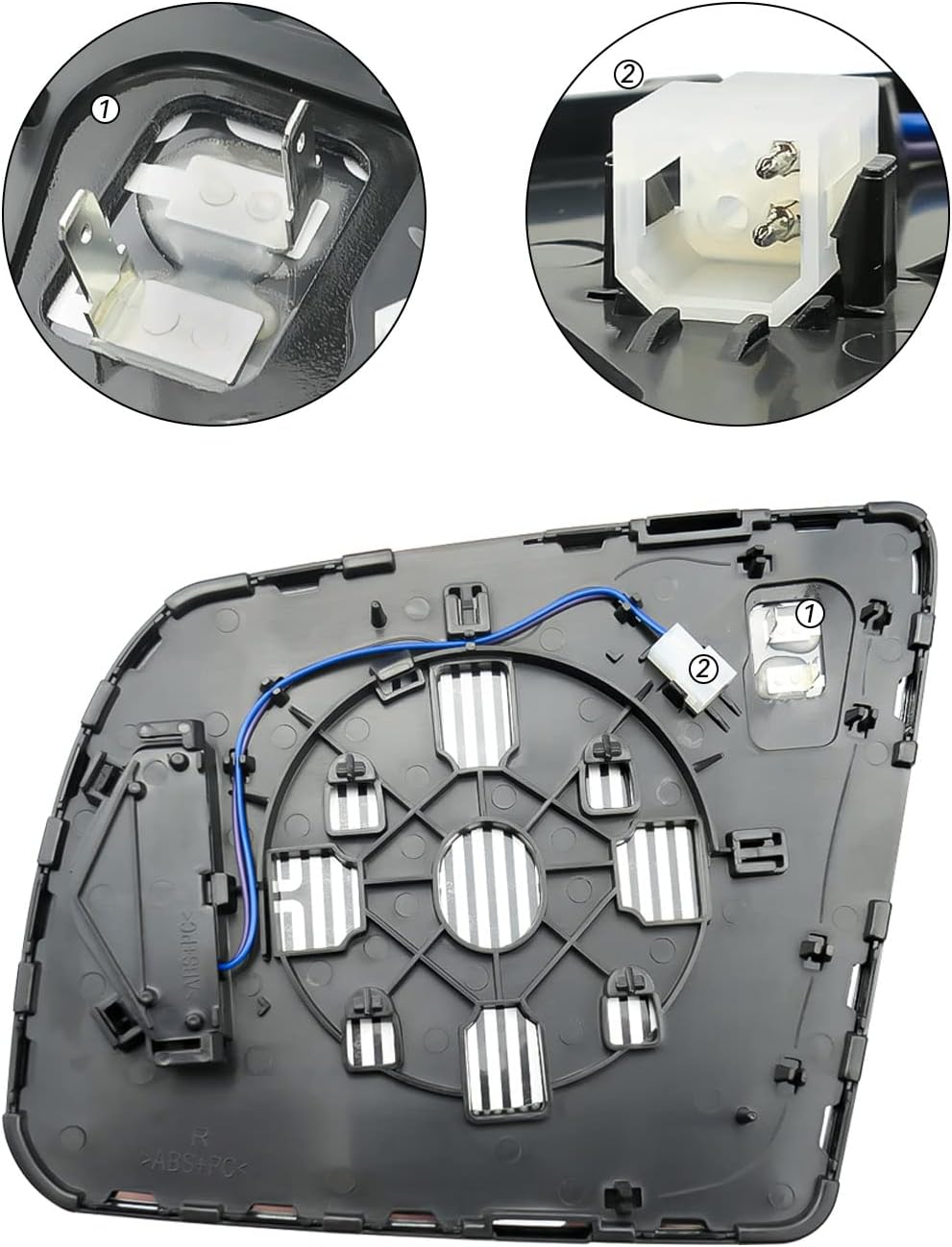

    Hi all,
    I’ve got a 2012 Limited with heated, power folding mirrors.
    Im trying to replace the cracked glass on the passenger side, but I can’t find a replacement with right mounting plate.
    Mine mounting plate is a circle of clips that attaches to a cylindrical mount. Pictures attached.
    This is totally different from all the Sequoia mirror glass replacements Im finding online.
    Any tips where to find glass with this mounting plate.
    TIA

    That seems to be an aftermarket mirror.
    I would try googling the number on your part..
    BTW Sequoia and Tundra use the same mirror glass.

    Challenge is that it seems that all the replacement glass comes with just 2 pins in the snap connector. In order for the mirrors to fold apparently you need a snap connector with 4 pins. Difficult to find. Anyone have a source?

    Update after to talking to Burco. The glass replacement they have for heat, signal, and folding is a “stick on” to the original glass that has a pass-through area that matches up with the arrow for turning. Not ideal, but gives me the electric folding capability of the mirror.
    Even the aftermarket glass that states 4-pin seems to be the size of the connector and not that it actually has 4 pins. The missing 2 pins provide the electric folding capability
