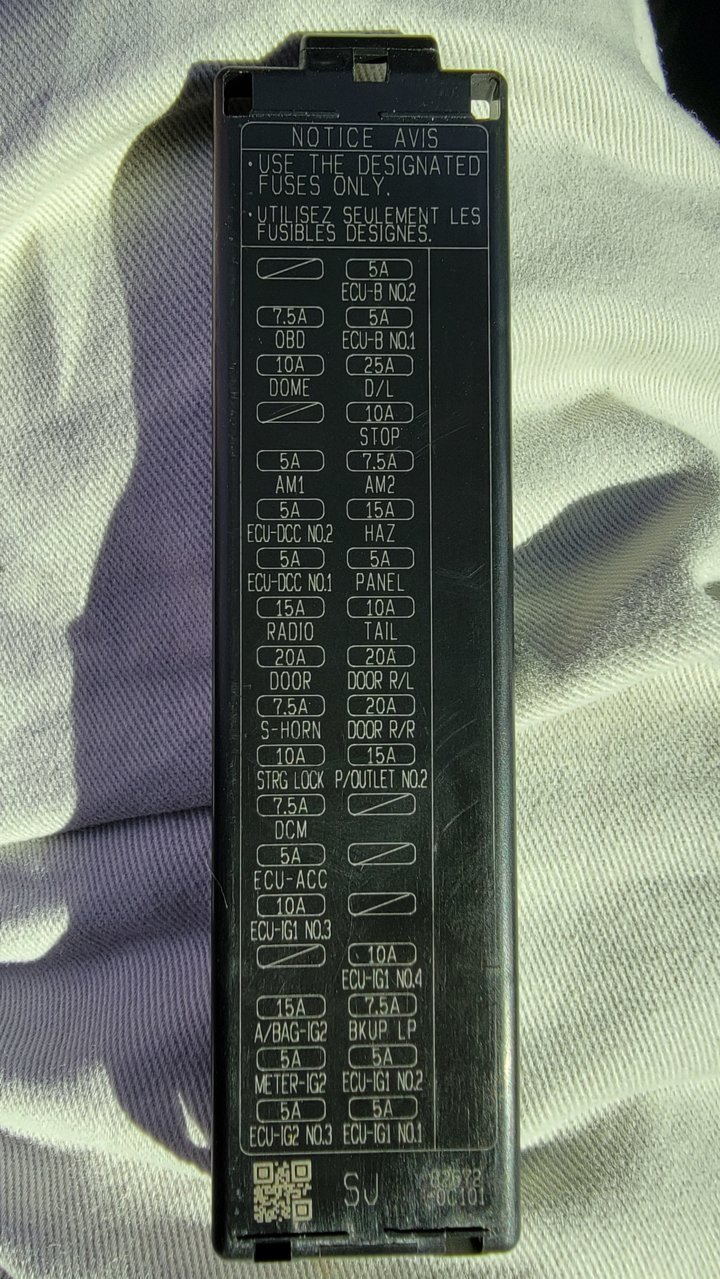

Grrr.... where is the cabin fuse? I can't find!

    Edit- i mean the cabin lights fuse

    There’s one under the hood in the fuse box. Labeled “Dome”.

    Well i must be blind :(20211225_173846.jpg

    There is most definitely an interior fuse box. It’s up behind the parking brake and requires a mild amount of yoga to get to it.

    Bummer! What year is your truck? I’d check that cargo fuse.

    Get a test light, and check every fuse

    My 2014 has a dome fuse under the hood as @BlueRibbon4x4 stated.
    I blew it a few times putting interior LEDs in.
    I sure didn't see one in the OP's box.
    I'd try anything labeled CIG, PWR OUTLET, PANEL, ACC, even CARGO LP.
    Check out this thread, there's gotta be an underdash fuse box.
    Interior Fuse Box Location and Information | Toyota Tundra Forum (tundras.com)
    It has a lot of fuses you won't find under the hood.

    21 interior dome fuse is definitely under the drivers side dash. I just replaced mine

    Yes on a 21 its 2nd down on the left under the driver footwell...
    thanks everyone!
