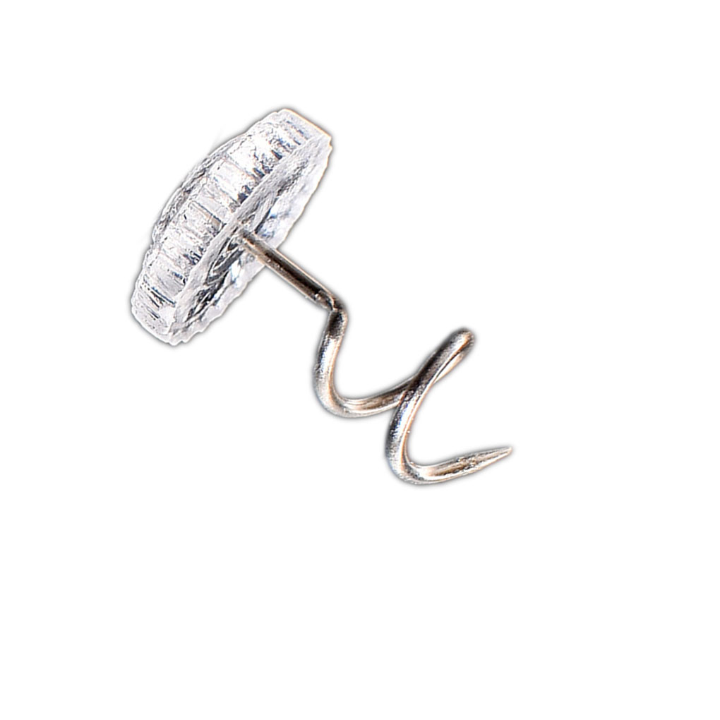

    You need furniture tacks- they are like thumb tacks but are spiraled so they stay in and will not pull out. Used them for that purpose on an old jeep once.
