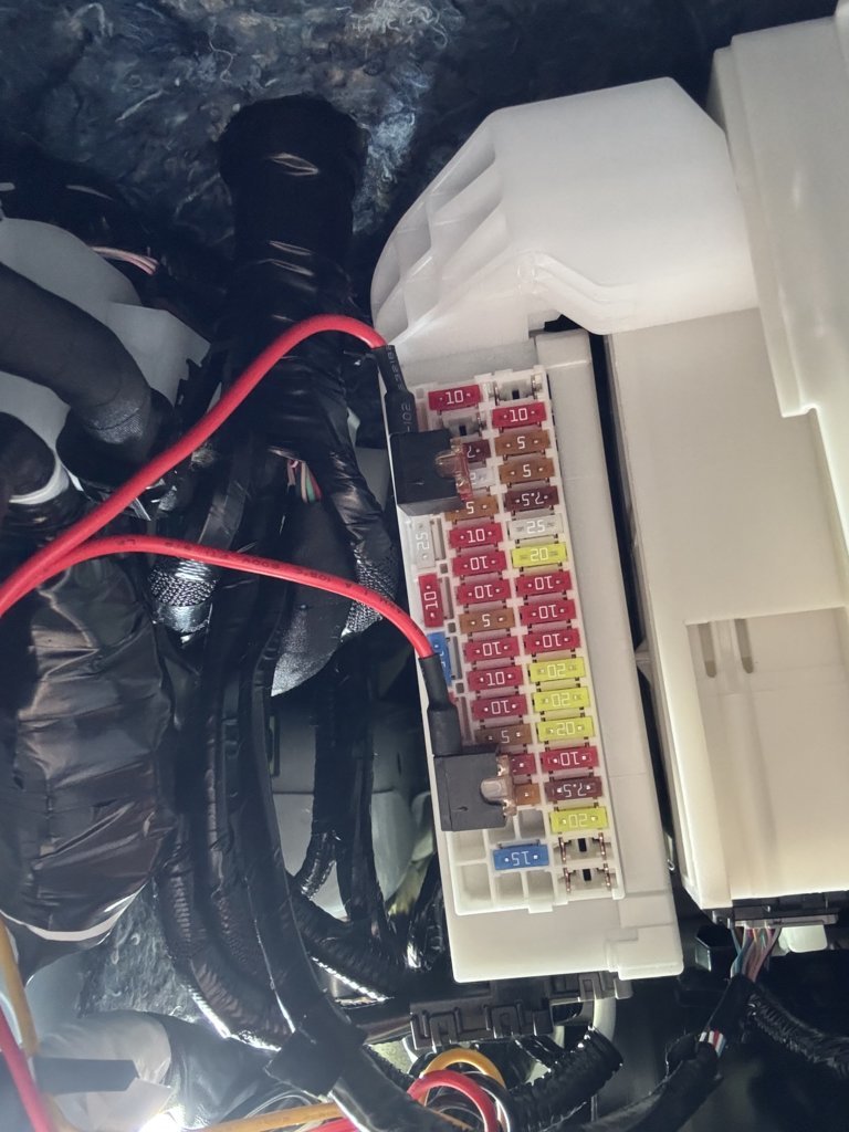

    My front cam is connected to the OBD port. Wires runs through dash, up A pillar, and behind head liner to dash cam. Rear camera runs similar from front cam down to floor, and similar all the way to the back.
